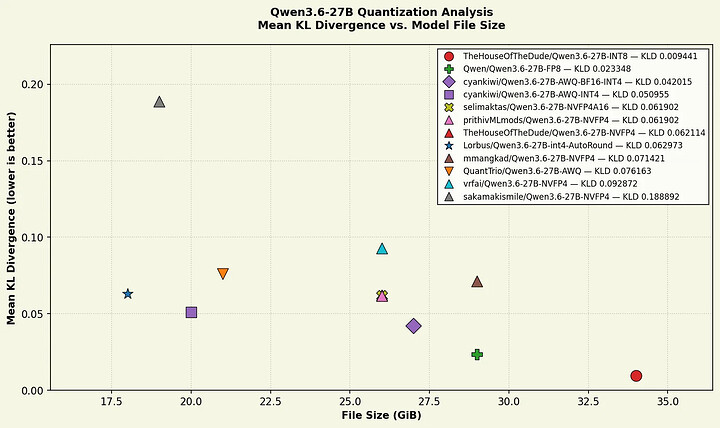

This image is getting dated but the story is worth repeating:
