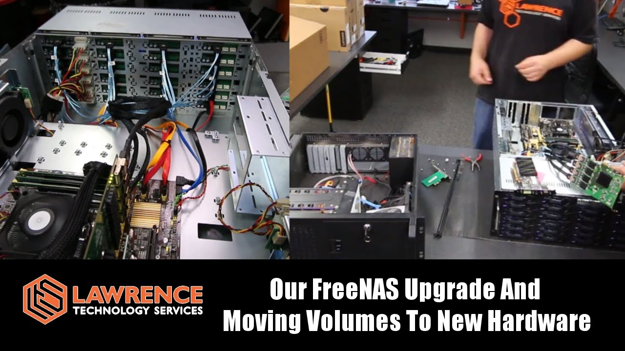

Finally, migrating ZFS disks between devices is by far the simplest thing ever. All the meta data is stored on the disks, so it’s just plug and play. That’s why RAID cards aren’t as good as HBAs. with an HBA, each drive is visible to the OS, while with a RAID card, all 4 drives will be seen as one, and could screw up metadata things. Definitly go on board SATA or HBA. The only issue really with migrating ZPOOLS is making sure the ZFS versions match up, as adding features can make it not importable to a system that doesn’t have those features. Especially going between FreeNas and ZoL.

This guy will answer all of your questions:
<3 Lawrence
