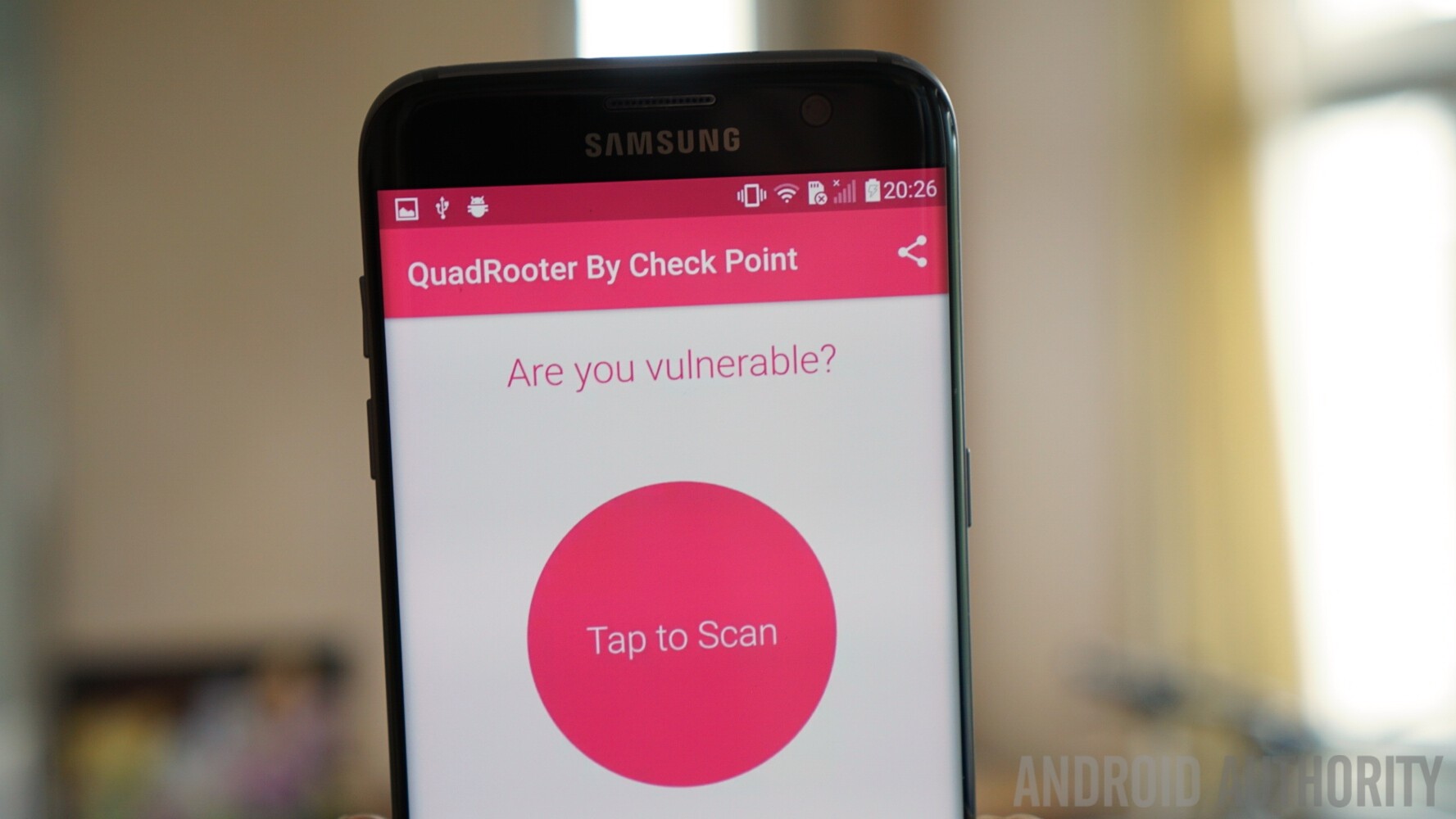

I was wondering if someone got Stagefright or Quadrooter working and how easily this could/can be accomplished (on vulnerable phones). Because even though there exists a Python sample on exploit-db, it is hinted at in comments that this exploit doesn't work simply out of the box and would have to be tailored to each device. As a result, Stagefright would become far less threatening, or did I get something wrong? If this were easily accomplished about 0.96 billion devices would be vulnerable.
Also, information on Quadrooter is rather scarce. Aside from CheckPoints paper I haven't found anything really useful.
I'd also be interested if anyone has some other information on probably dated security vulnerabilites concerning Android, since I'd like to test them myslef.
As a final note: I don't intend to do anything malicious, I'm interested because I'm writing a thesis about exactly that (and any additional information/insight is always welcome )

AndroidAuthority is also great for this stuff too.
