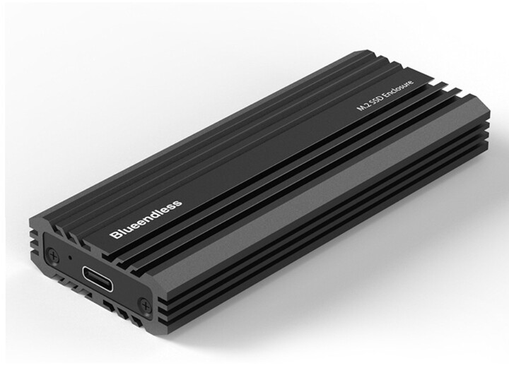

Very similar to what I ordered a second ago(above that was only RGB Asus in terms of price) …

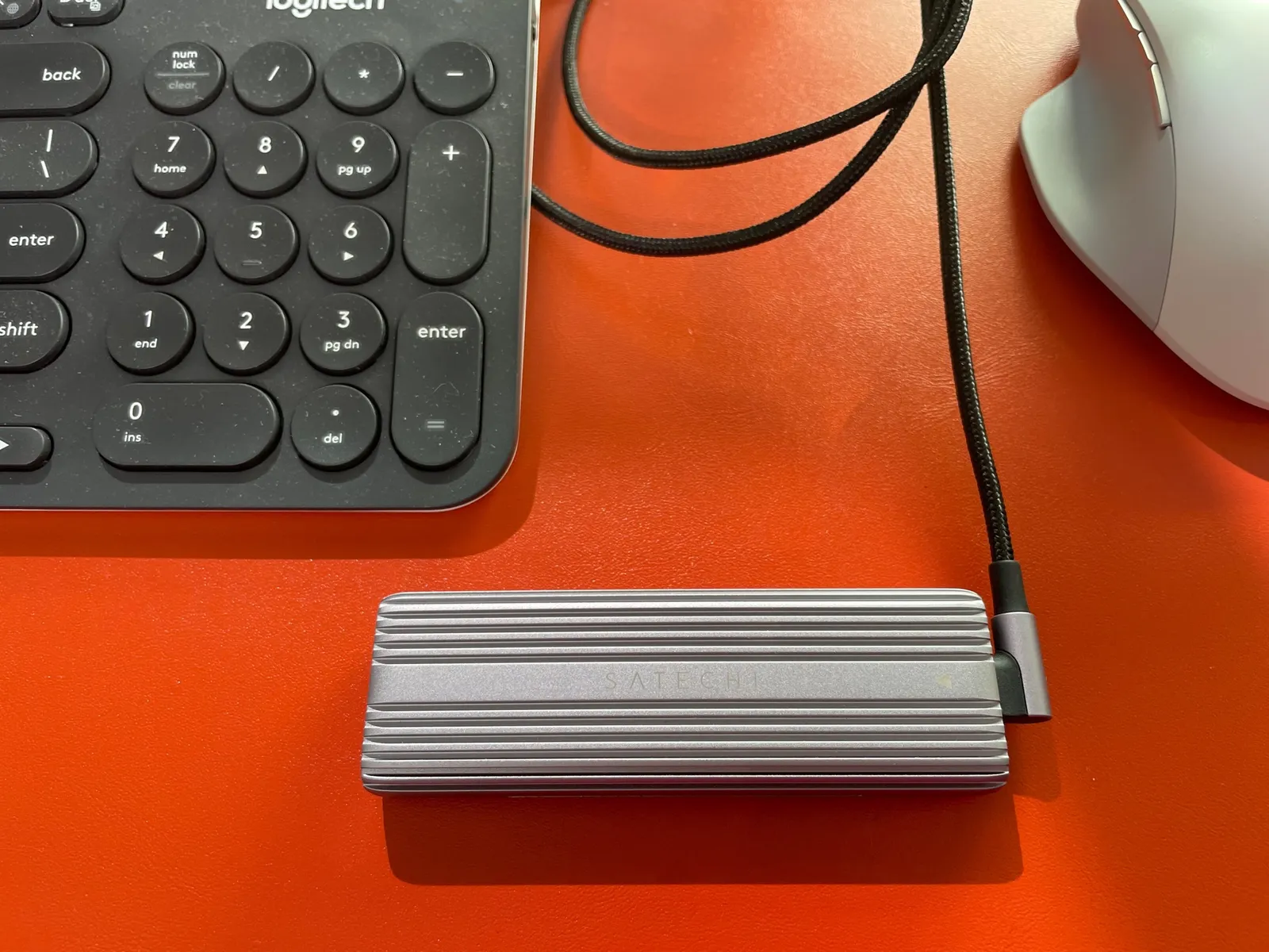

Fyi, there are toolless designs with manual locking mechanism liker the satechi. Also sort by enclosure weight, its proximate measure to how good heatsink it is.
I would avoid noname variant unless there is physical review that checks basic design. Some are truly shitty, as in little to no thermal interface with enclosure itself.
For reference, SATECHi usb-c m.2 enclosure was about 100€ with quality cable included.
