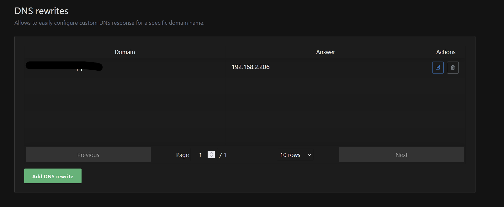

Cheers for the quick reply. I have previously tried setting DNS overwrites in Adguard but since I cannot specify a port, nothing will be found. All services are exposed via their respective ports on my Server. So simply adding something like this, sadly doesnt work.

This is correct, DNS records have zero information about target ports, only IPs. The record you’ve added in “AdGuard rewrites” only tells where the client (e.g. browser, curl, etc) should go in the network (IP) to reach something called “srv1.mydomain.com” (for example).
Technically this should already work, you just have to specify the port of your service. Let’s say srv1 is listening a port 8080 (and is a plain HTTP service), then you should be able to reach it via “http://srv1.mydomain.com:8080” from any machine that uses your AdGuard as DNS resolver

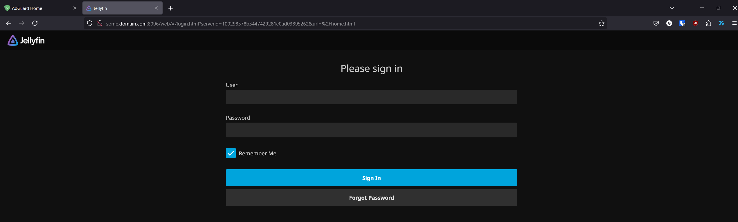

Adding the DNS rewrite in Adguard and then adding the port at the end like “some.domain.com:8096” does work. Had previously done so for testing but I do want to get ride of the port.

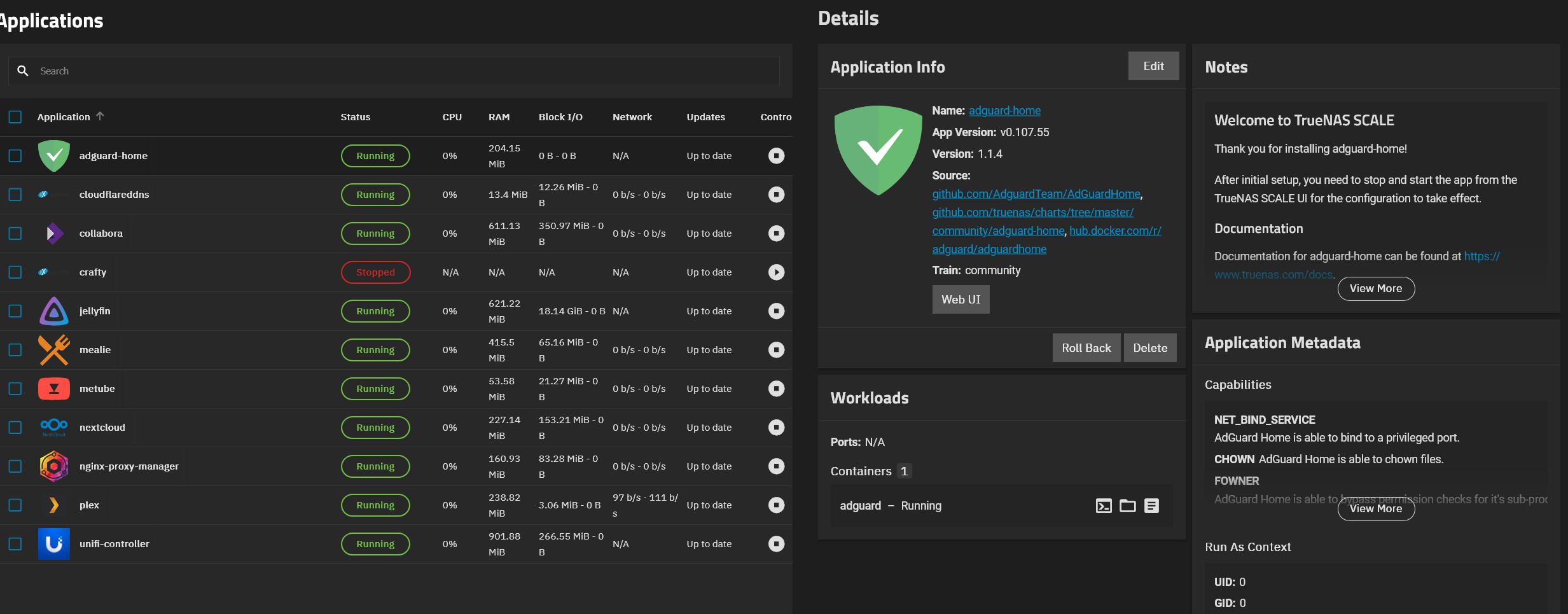

The services I’m trying to reach can be seen here
The services listen at 192.168.2.206

So if I add an AAAA-Record in Adguard Home now, it should just redirect my internal traffic directly to the server instead of going outside my network and then back through my home-ip → server, correct.
Not “AAAA”, this is for IPv6 world. Just “A” record.
But in general - yes, AdGuard rule with take precedence over the cloudflare provided address, so you’ll be hitting your server directly over internal LAN
