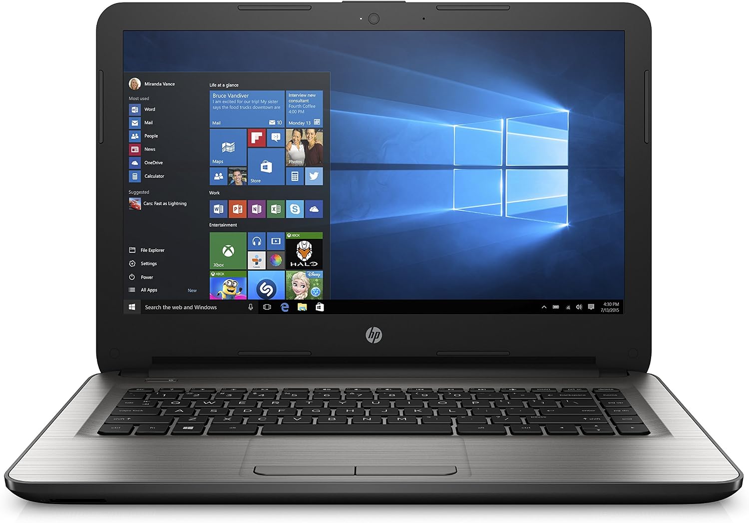

Anyway i just recently finished my build and i think i will start saving up for a cheap laptop just for school work, any suggestions? It's only going to be for school homework like programming, office and also i will be using some software like Multisim and Matlab but not in an intensive way, also some web surfing/youtube. I think my budget is in between 200-250 ish, the less the better i think(no used or ebay).
This was about the best I could do. You'll probably want to put a new hard drive in but you should still be on budget. No worries. Glad I was able to help.
Looks like a good option :) I can swap there the HDD that i already have but anyway i would like to save for a ssd too. Thanks for the suggestion!
