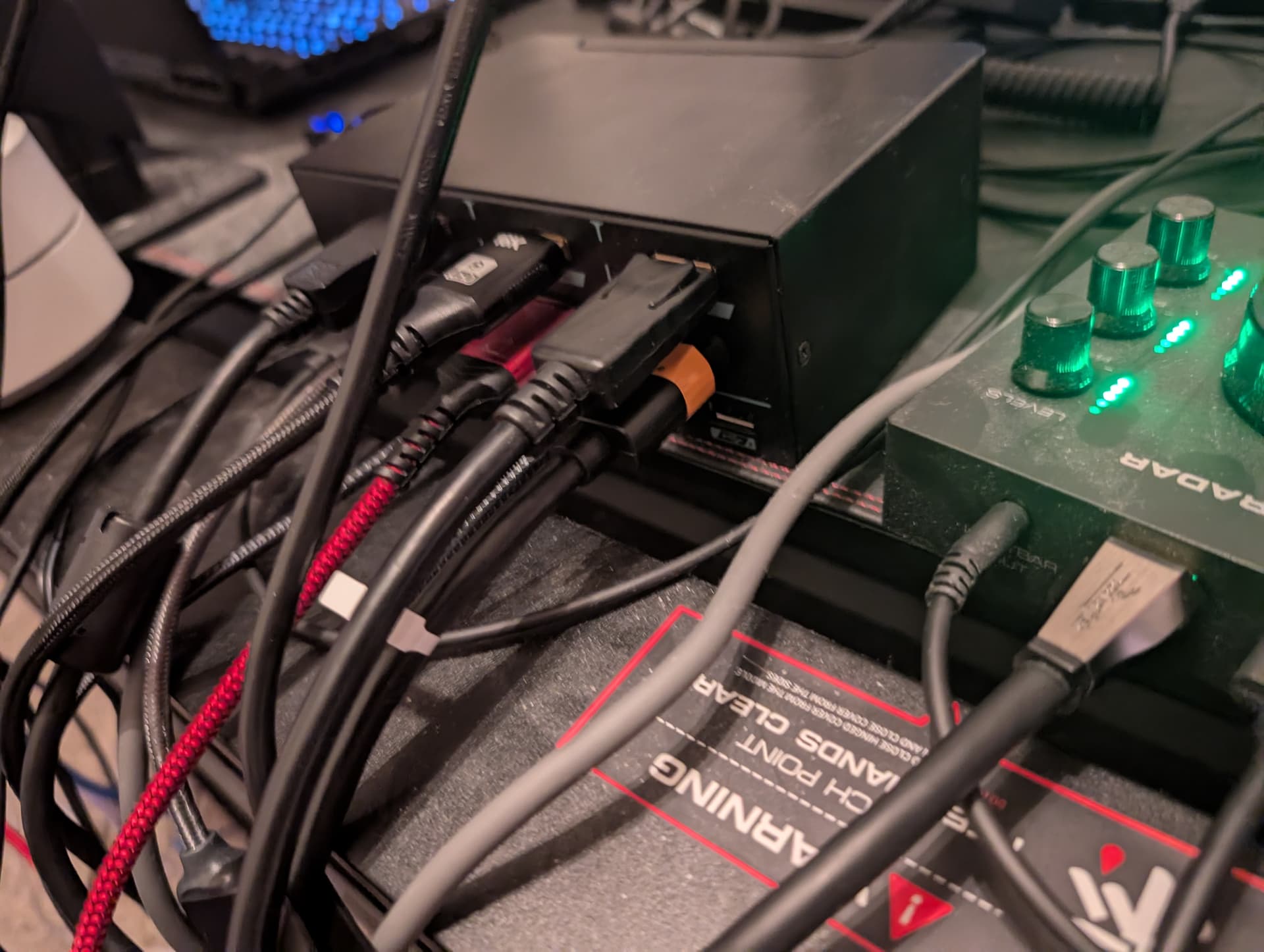

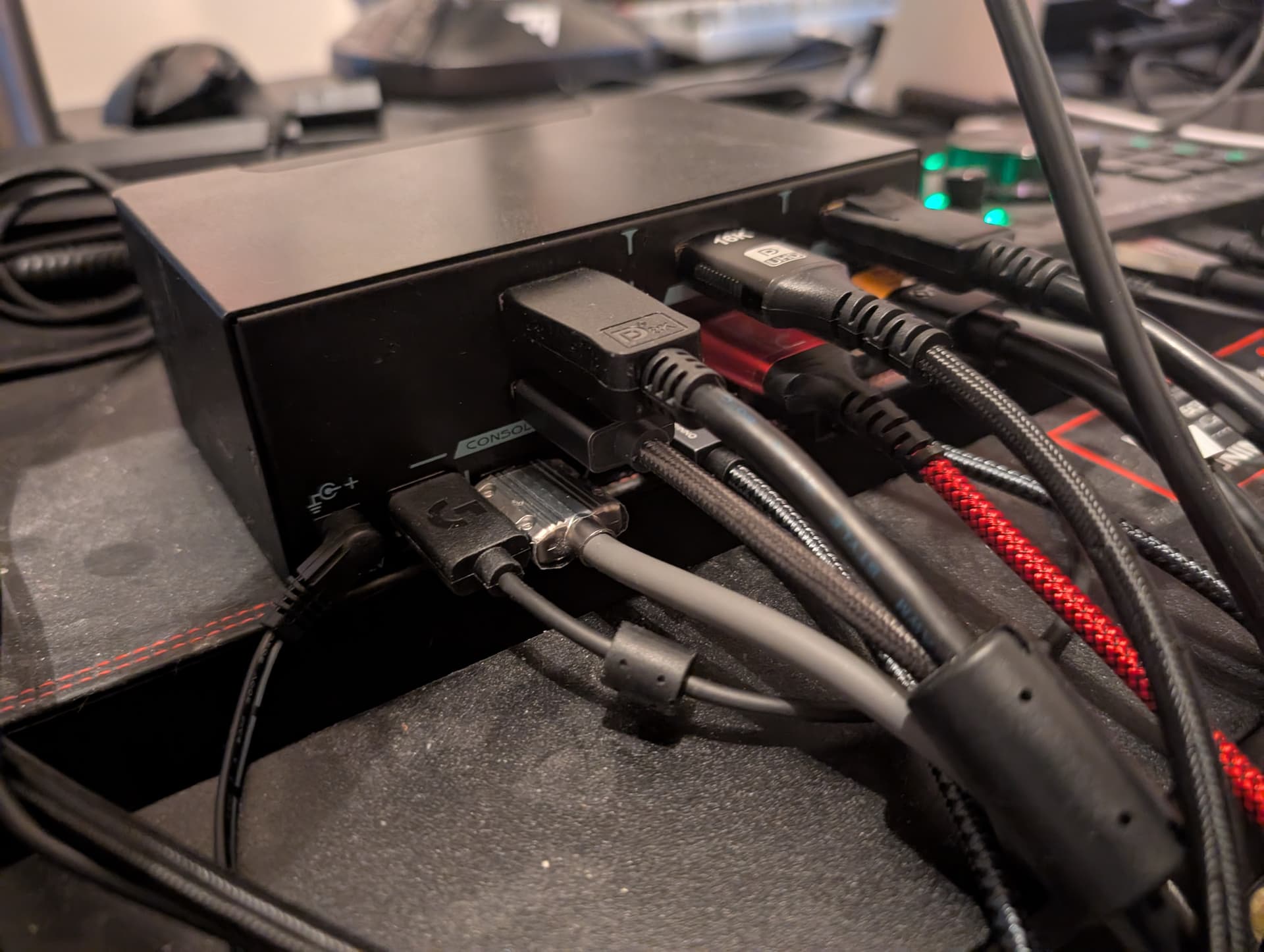

can you take a pic of the back of the kvm how you have it cabled?
Here are the screenshots.

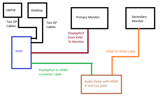

I will draw something up to help you visualize the connections.
KVM and Audio Radar with two monitors
Ideally, I want to connect the Audio Radar with the KVM’s output to output lights based on audio from whatever is currently active (Laptop/Desktop).
Does that help unpack what I am trying to do here?
