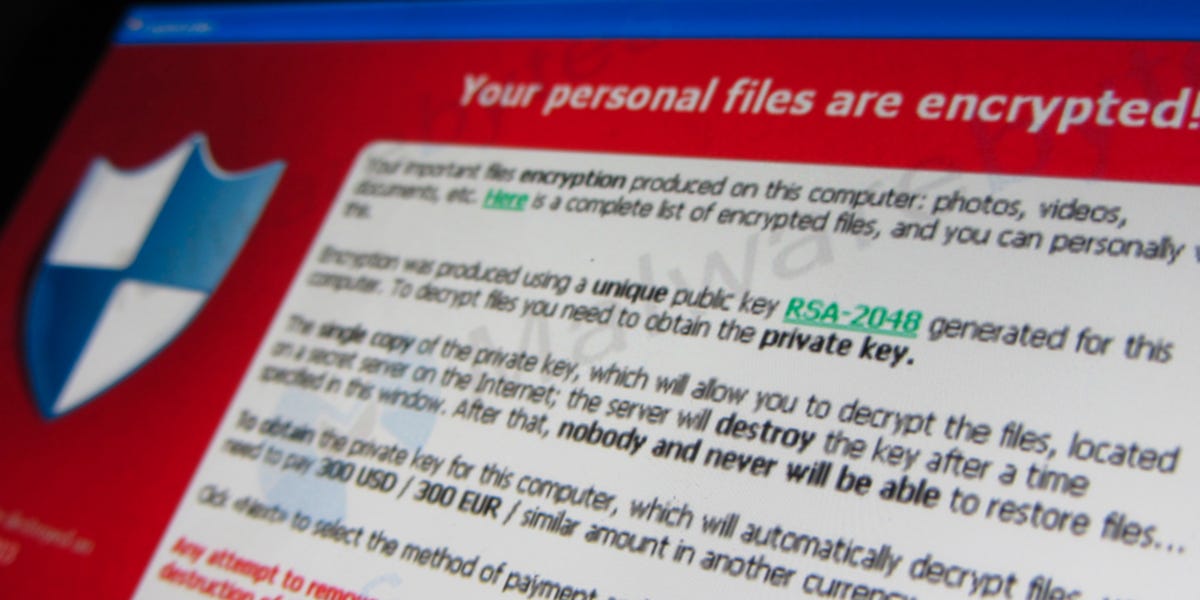

My client is a law firm with about 100 employees and hundreds of thousands of folders of data. Due to an iffy backup solution that so far we have not been able to recover completely from, we contacted the hackers and were told that the ransom would be $1950 worth of BTC. Money is not the issue, they just want all of their data back. This is my first time encountering this virus and I knew people here would have experience on this. Is it worth it to try other measures besides paying the ransom? Are there any?
Thanks for any help, the longer we wait the more money they lose.
