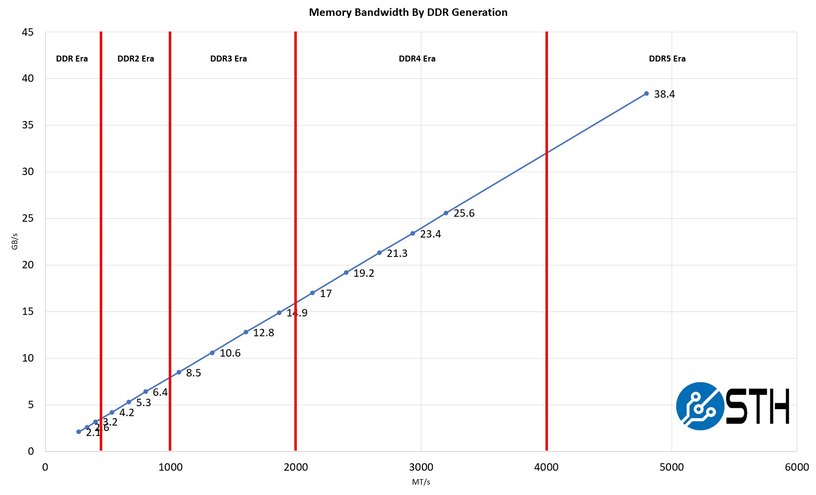

You might be getting close to RAM limits? I am unsure how to measure this, but DDR4 at its lowend is sub 20GB/s for a single channel as per this guide on ServeTheHome
