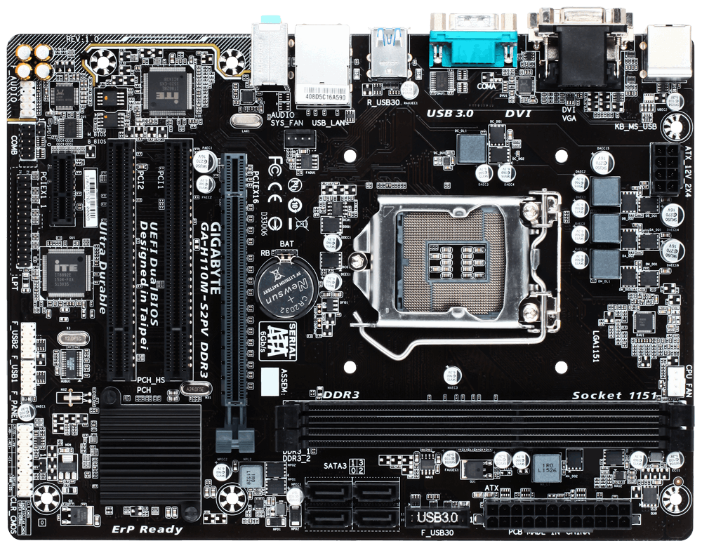

Sadly cannot do this. I only have 1 PCIe x16 http://www.gigabyte.com/fileupload/product/2/5493/20150916135933_big.png
