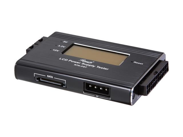

Hey, thanks for the reply. While I can get a volt-ohm-meter I'm not electronically savvy enough to be comfortable testing something potentially dangerous (it seems simple enough, but I don't care to fuck around with electricity); the PSU (Antec Earthwatts 650) is about 6 or 7 years old now, so it's probably time to replace it anyway. What I might do is get a new PSU (corsair rm650x seems good), and if the problem still occurs, look into getting a new motherboard.
http://www.newegg.com/Product/Product.aspx?Item=N82E16899261023&nm_mc=KNC-GoogleAdwords-PC&cm_mmc=KNC-GoogleAdwords-PC-_-pla-_-Tools+-+Network+%2F+PC+Service+%2F+Acc.-_-N82E16899261023&gclid=CNGakuqFl84CFURZhgodmHQAIA&gclsrc=aw.ds
Get one of these, it's super easy, no need to be intimidated.
those testers are good for two things.
1)it gives basic voltage reading,good to check if psu isnt total crap without any load ( voltages may be ok if there is no load or load is minimal) so not much of a help. It may not be stable under load. to test a psu you need a testing unit that draws actual power.
2)when you are making custom cables to check if you connected pins correctly .
