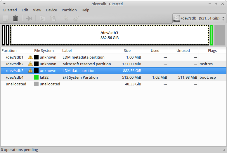

Hey guys,
I am in deep shit. I had a problem with windows updating, which rendered my pc basically useless. Now I’m running on xubuntu, I had hoped to see all of my drives pop up immediately. However, my 1tb internal hard drive is not being mounted. I have searched the internet empty and I just cannot find anything OR am too stupid to understand it.
I would love some help from people who, unlike me, actually understand this stuff. I have attached screenshots of my problem, if more info is needed I will upload it accordingly.
The 882.56 GiB partition seems to be my Data.. I guess. The hard drive had nothing to do with my windows installation, it was used as a storage hard drive for media, documents and all of that.

/dev/sdb/ is the hard drive i have troubles with, which is the one you see in the screenshot.

What confuses me is why this would affect a second hard drive. I’ve reformatted my main SSD several times without affecting any of my HDD’s. Apparently I need to learn more about partitions and file systems.
well sorry if i wasn’t clear enough in my initial post, but updating didn’t break this hard drive. I had no issues whatsoever with it on windows. I just had a lot of issues with the w10 installation. So I installed xubuntu, removing windows. Now I cannot access that hard drive. I also don’t know why it’s supposedly a ldm partition.. oh well.

Back to the subject at hand, I’m curious if xubuntu reformatted some of the 1TB drive to use for itself, but ended up only reformatting the MBR (if I’m using the term correctly.) So the data is there, but nothing recognizes it as data, just as “hey, something’s here, but there’s not a record telling me what this is or how to read it.”
