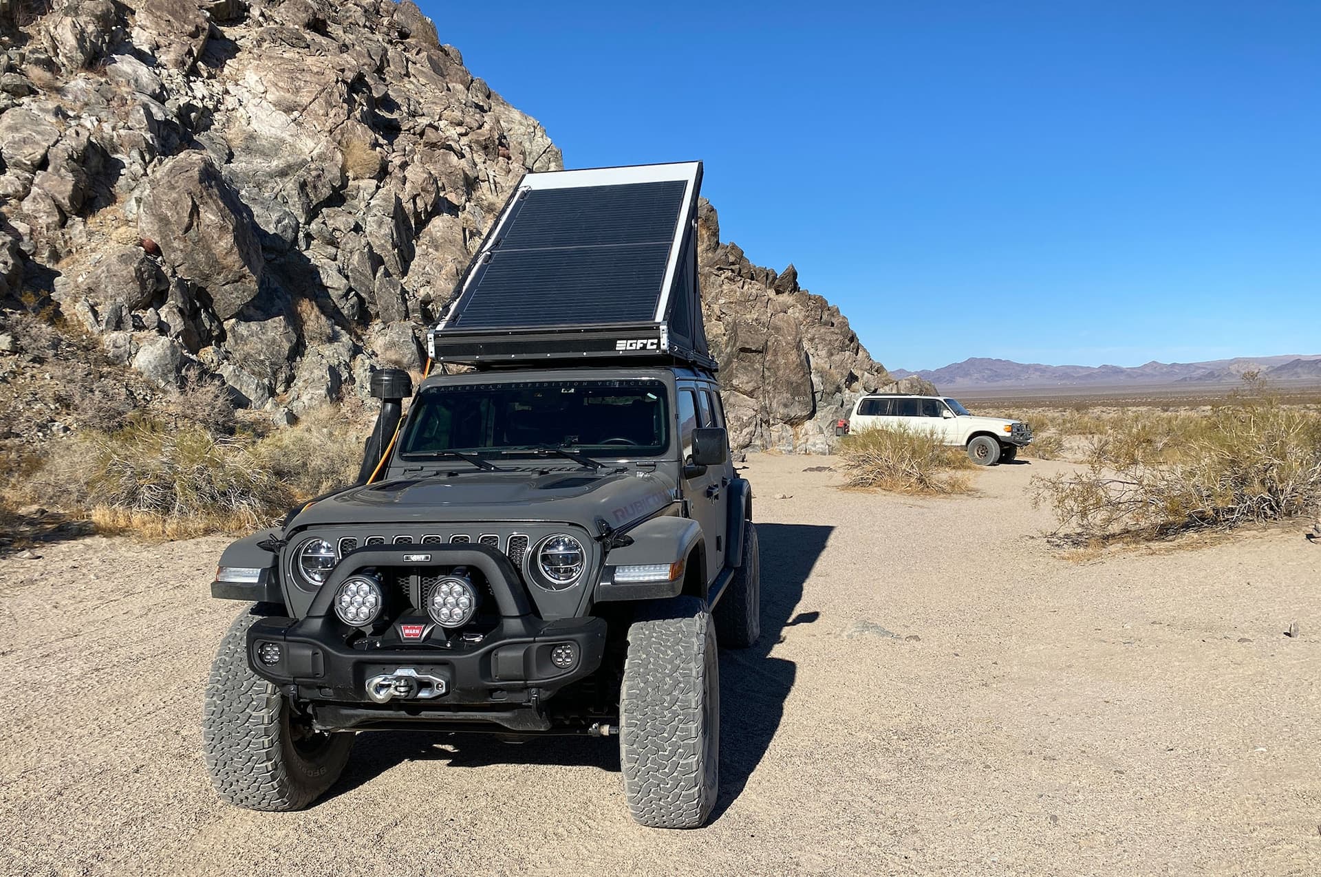

Closest I’d entertain, for using “fixed” panels, would be towards overlanding sh!t
[image for reference]
I do wonder how many times per hour that car would stop, and people would go outside to wipe sand of that panel.

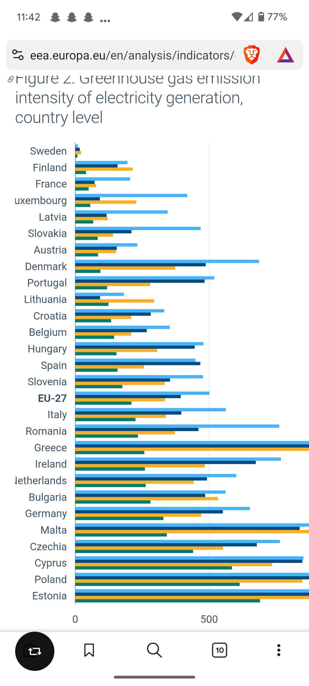

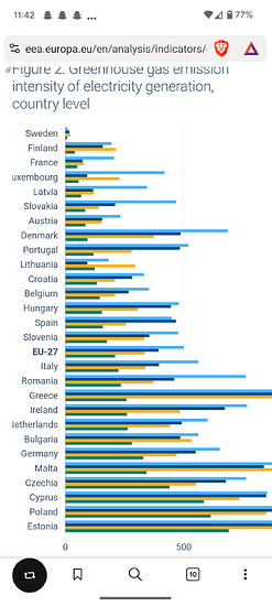

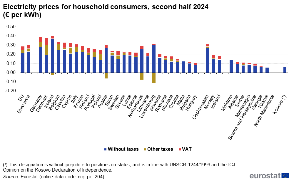

Spot prices for electricity does not include taxes and transfer fees.
Also Germany has one of the highest CO2 emissions per kWh in the EU.
Source 1
Source 2
If we are including taxes and transfer fees, Germany is doing about as poorly as Ireland and Denmark. Unsubsidized solar with storage can be produced for ~€0.15 per kWh in both Germany and Sweden. Guess what households are going to install once they realize it’s cheaper to pay an upfront cost of €30k for 30 years than trickling €150 a month for 360 months? :slight_smile:
In some countries in Europe, it is already cheaper to install unsubsidized Solar on your roof or balcony, than it is to pay the transfer fee. Sweden is one of them, where you can get a hold of a 20 kW solar panel system with a 20 kWh battery for below €10k now (with subsidies) and twice that (without). Doing the math, that equates to about €1k per installed kW unsubsidized for something that produces at least 800 kWh per installed kW per year. If you use all power you produce on that solar array (which you will not) for 30 years straight, that is about €0.042 per kWh. Even if half of it is wasted that’s still €0.085 per kWh.
Swedens transfer fees are at €0.045 at the moment with another €0.055 per kWh in energy taxes (using the inaccurate-but-mostly-good-enough 1€ = 10 SEK conversion). And by 2030 you can buy the same system for €5k in Sweden, unsubsidized. Biggest cost is already the labor to put it in, so it’s mostly ROT in either case.

First off, your graph is cut off.
Second, it only lists up to 2023, so a bit outdated already.
Third, it still shows a growing trend of decarbonization and Germany still does not have unreasonable electricity prices - just high ones, and a lot of that is due to coal.
First off. I linked the sources so no need to get upset about my screenshot.
Solar panels are definitely a way to produce electricity without making any emissions. The only problem is they all come from China at the moment. I don’t have a good source on the actual emissions from solar panel production, but my guess is that it’s not exactly clean.
I was in a bit of hurry when finishing that post, so do forgive my short answer - the graphs being cut off misses the legend so it’s better for transparency if you include the entire image for the discussion. But kudos for the sources though. :slight_smile:
