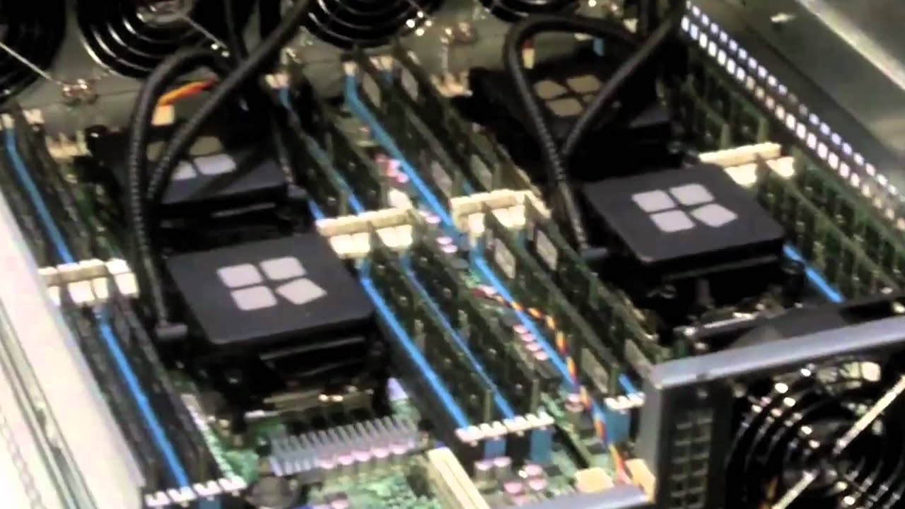

looking more into coolit, seems they are the OEM for corsair water coolers. also they mainly make products for datacenter, so what you might have could be a watercooler for a server. the longish radiator might suggest it was meant to be mounted horizontally in a 2u-rack server chassis, how thick is the rad?

There are two big makers of AIO liquid coolers, Asetek and CoolIT. They make pretty much all the AIOs on the market, be they Corsair, NZXT etc etc. There are only a couple small exceptions. Nothing special with that CoolIT cooler, test it out on some heat source to see how it performs.

The PDF i linked there is probably the specs for the pump-block. The radiator is probably harder to find, looks like it is built for some specific system. Will probably be a bit interesting to mount it in an ordinary PC case as it looks like it lacks any mounting for std fans etc.
so this looks like it
Nice find.
largest company (never heard of them)
