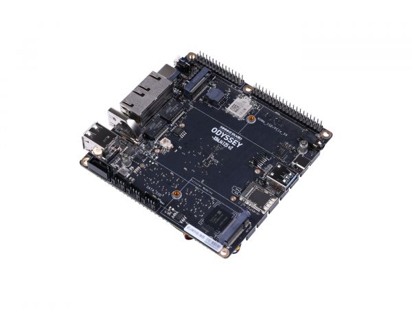

Checkout the Seeed Studio Odyssey with eMMC: Just need the board + Power supply + case and you’re done:
On the product page they describe using it for pfSense: https://files.seeedstudio.com/wiki/ODYSSEY-X86J4105864/img/X86-04-n.png
