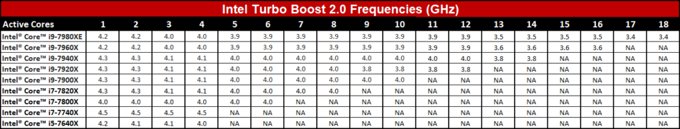

Love that all core boost clocks way fucking lower then their boost you see on the image
Those 2.0 boosts look good till you look at how it breaks down when more cores are used.
Yeah they should really stop with these obfuscatory terms – just list the possible all-core turbo, max single core turbo; the ‘base clock’ is meaningless given that everything now downclocks when idle.

Okay. So you’re saying that 2.0 boost clock thing is a lie? Or is there a bureaucratic reason why avx(2) perf isn’t relevant for those turbo 2.0 minimums?
No boost 2.0 is what it will go to if there is not issues with power/temp ect.
3.0 = 2 cores.

No it isn’t a lie.
AVX loads use quite a bit more power and therefore can’t boost as high. You’ll likely still see some boost over base but not as much. Bar clock is just absolute minimum under worse case scenarios.
If the motherboard has all core enhancement which nearly all do now the boost becomes less relevant since it pushes all cores to max turbo. Basically an automatic overclock
