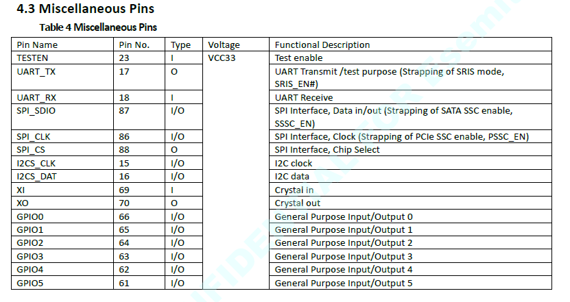

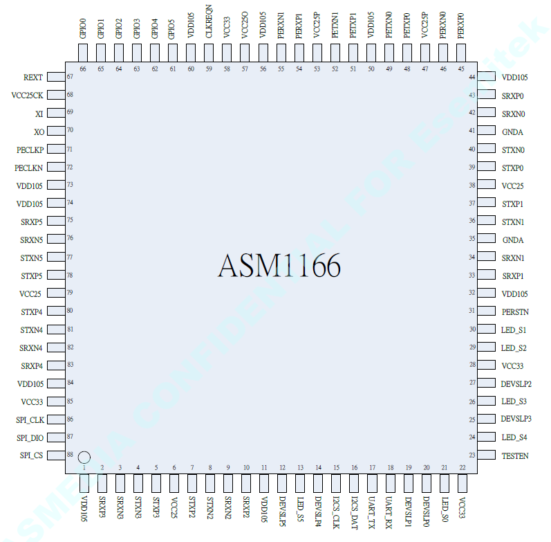

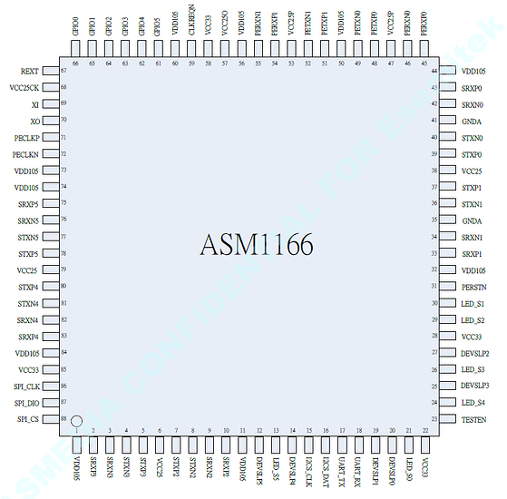

With some soldering it should be possible to access the UART interface on the Radxa board. Pins 17 and 18 on the ASM1166 controller:
From ASM1166 datasheet

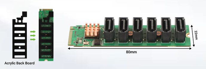

There is an acrylic back board:
But there is nothing yet to protect the M.2 connector… though in my experience it should be strong enough.

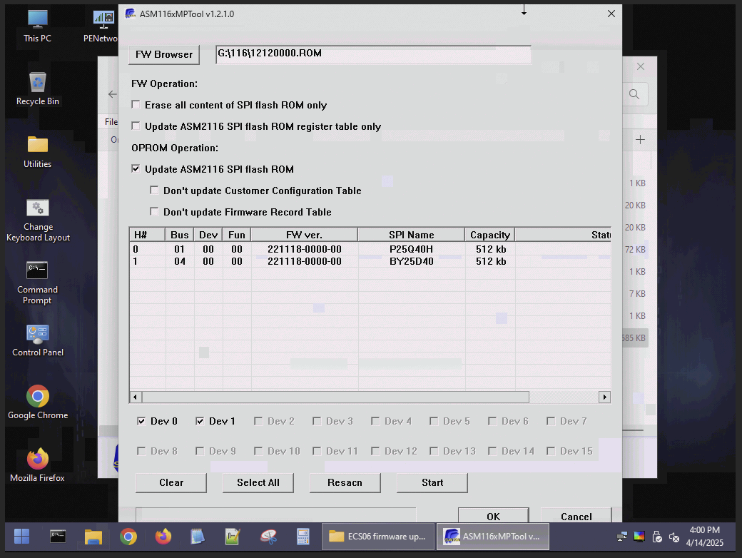

@dmc Sorry for the delay in getting back to you, here are the flash chips identified on my PCIe and NVME-form factor cards by the Windows flashing tool:
P25Q40H
BY25D40
Both claim to be 512kB.

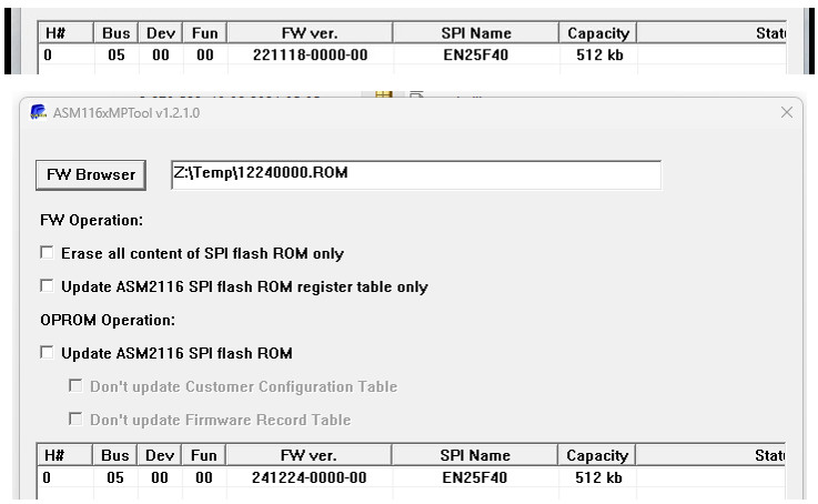

Looks like there’s an even newer firmware - 241224-0000-00 (YYMMDD-****-** format?) available here - Asmedia ASM-2116/116x Sata 6G Controller Firmware Version 12240000
Someone has flashed it successfully here - Latest Firmware for ASM1064/1166 SATA Controllers - #79 by Kommandore - BIOS modules (PCI ROM, EFI and others) - Win-Raid Forum
I updated my ASM-116x Controller from 221118-0000-00 with the newest Firmware from station-drivers ( Asmedia ASM-2116/116x Sata 6G Controller Firmware Version 12240000) and it works fine.
Another person in the thread also notes that (I believe compared to 241025-0000-05) this firmware supports PCIe MSI again - Latest Firmware for ASM1064/1166 SATA Controllers - #80 by boombastik - BIOS modules (PCI ROM, EFI and others) - Win-Raid Forum
Also it enables again message signaling (msi)
