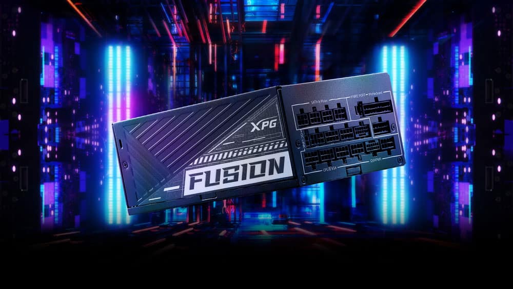

went to power on my system this evening after having it off overnight, hit the power button and my finger barely touched the power button, IMMEDIATELY the BANG in the room sounded like a gunshot went off, the whole house panicked.
system is a ASUS wrx90, 7975wx and rtx 4090 so I’m praying the psu did its job and died without killing everything else. no burnt pins on any power cables, no obvious burns on motherboard and no electronic burn smell except very minor smell from psu, I have to be right up against it to smell it.
psu was a xpg fusion 1600w, xpg co-developed this psu with delta electronics who makes server psu’s so hopefully they carried over good protections to this unit. this was one of the first production units from mid 2023 when it released so could be a bad initial production run.
I would buy a different brand since this happened when it was less the 2 years old, but I had to buy custom 40-inch-long cables to fit my lian li v3000 plus case, and I can’t wait weeks to get a different set of custom cables for another brand psu to see if it killed something else.
and the last kick in the teeth, xpg rma site is screwed and won’t process my rma request, so calling in tomorrow but 2 weeks to a 36 day lead time on rma’s are listed so I have to foot the bill to get a new psu to check the system asap.

If the psu has good protection which you kinda could expect from psu´s of that nature,
than you should be fine really.
HWbusters / Cybernatics did a review on that particular psu or at least the XPG Fusion 1600W platinum unit.
And they included it in their pick list so it´s definitely not a bad product.
But with electronics nothing is really fail proof of course, sometimes it can happen.
And will take some deeper analyses of why the unit failed.

sorry for the late response, been a busy time this month. long story short everything survived, system works great still. looks like I most likely just got a faulty unit from the early production run.
the longer version,
  1. the xpg website being screwy, it seems like a programming error on their site, as the psu has a 12-year warranty, my thinking is whomever added the info about this psu to the website accidently put it as a 12-month warranty and the system wouldn’t recognize the psu being still under warranty because of it.
  2. I contacted B&H photo where I bought the psu, their customer service is incredible, they contacted me about an hour after I emailed them, they then contacted xpg for me and I had an agent from xpg contact me less then 24 hours later, had a rma form sent the unit in. I was expecting a long wait since the xpg website said 14 to 36 days wait for rma’s. they had my unit 3 days later and got my replacement sent to me 2 days later.
