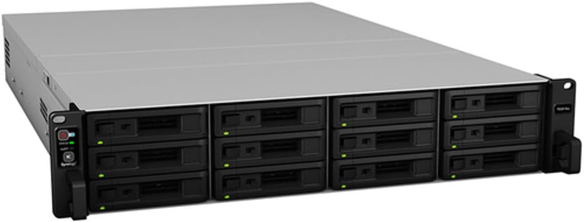

I would have to agree with @ThatGuyB and advise against what @level_double_o_null is planning. I tried something like what @level_double_o_null has in mind and had a lot of bitrot. I might be able to retrieve some of my files, but I doubt I will be able to retrieve all of my files. So I am saving my money for a Synology.
