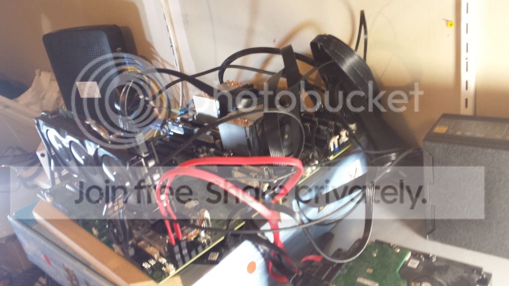

Unfortunately these coolers didnt work together in the orientation I wanted though and my measurements were a little bit off...
Dremel fixed it though.
Unfortunately In the days of getting this thing to actually work I had a lot of issues with the RAM so this computer is still running on piece of cardboard rather than in the case... that will be fixed in due time and I will make sure to put some photos up but girlfiend moving house and the project i have at work at the moment is taking up all my time (and space).

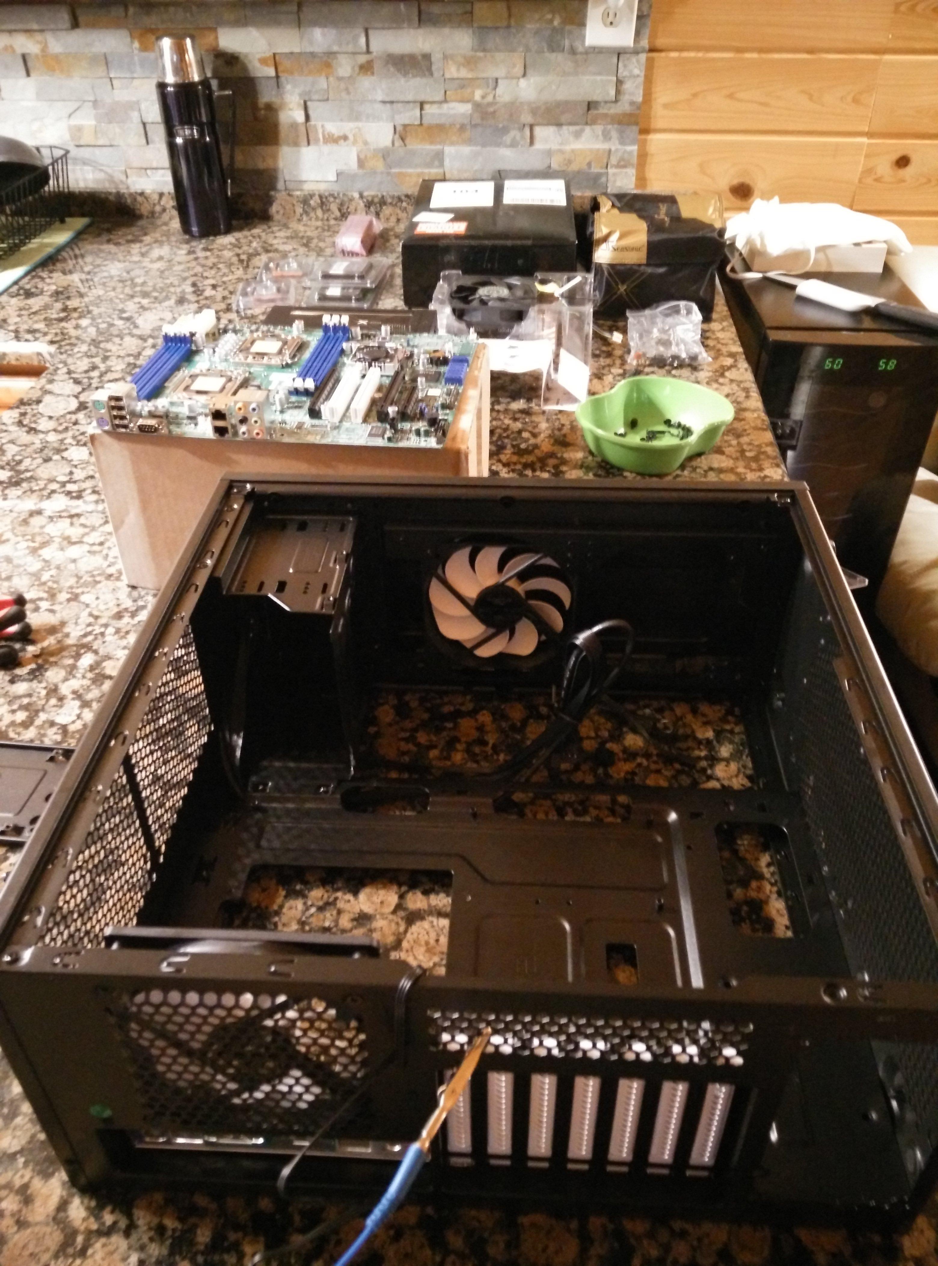

Just adding my two cents to this.
The premise behind this is a friend wanted a build that could do CAD and play some games while still being pretty cheap. I took this as an opportunity to throw some random things in a case.
This is a dual xeon build, but the USP (unique selling point) is that its in a normal ATX case. It is mostly built out of extra parts I had and ebay of course.
motherboard: SuperMicro X8DAL-I
dual cpu's: Dual X5660
The PCpartpicker link is to the original build i posted there. It has lots more pictures and specs if your interested.
https://pcpartpicker.com/b/PWLD4D
still going strong today.
