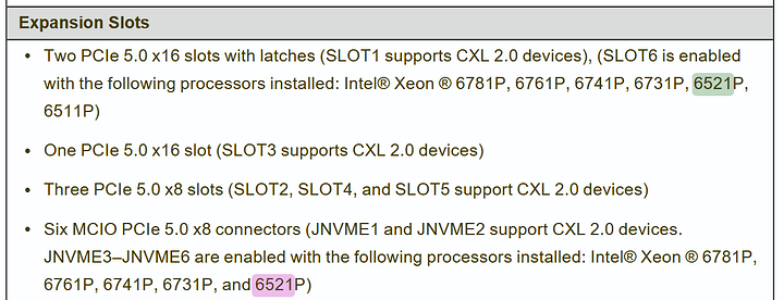

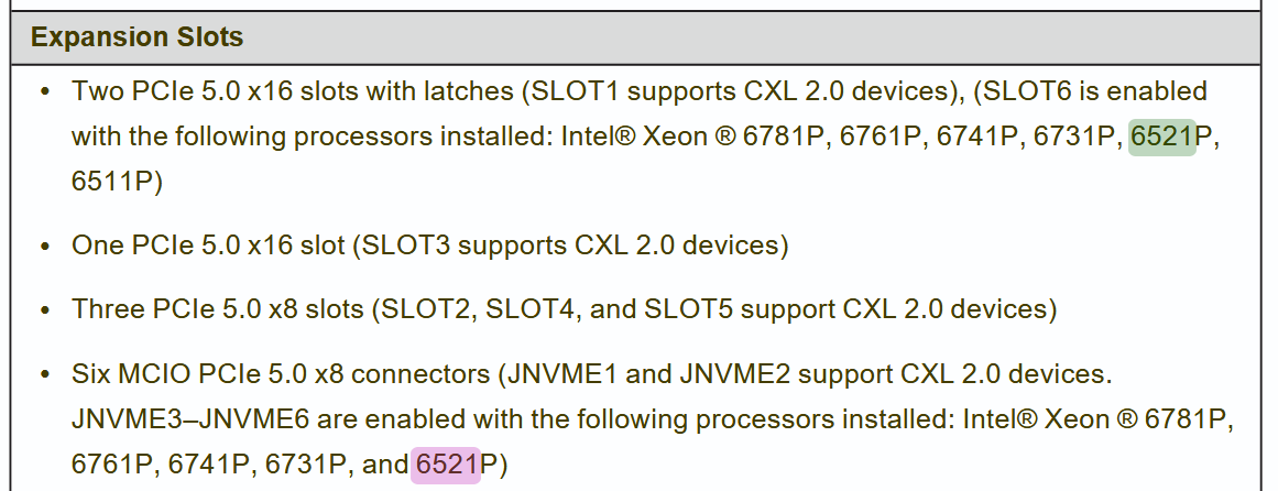

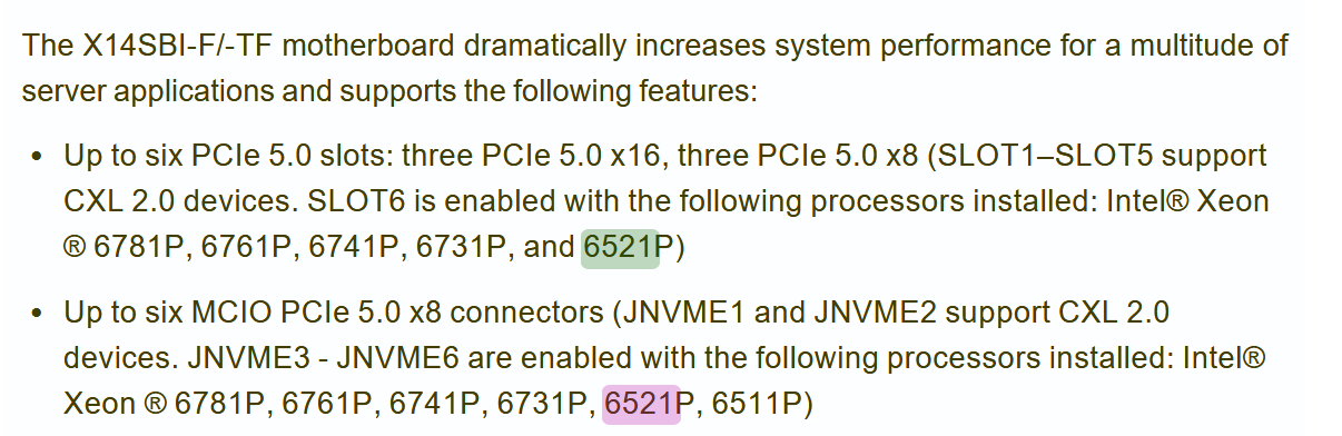

I’m looking at the X14SBI-TF’s manual and it is explicitly and inconsistently making a distinction between the 6511P and the upper stack of the 1S processors:
Then 4 pages later:
at first it’s saying the 6511P will enable PCIe slot6 but not all the MCIO connectors; then later it’s saying the exact opposite.
I think your right that it is an oversight in documentation.
