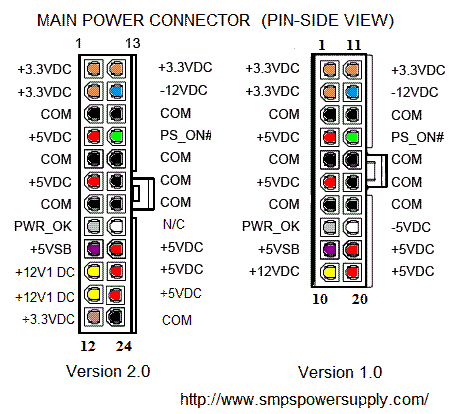

have you tried shorting the ATX cable to see if it is a problem with the motherboard?
Short the green wire to a black wire
