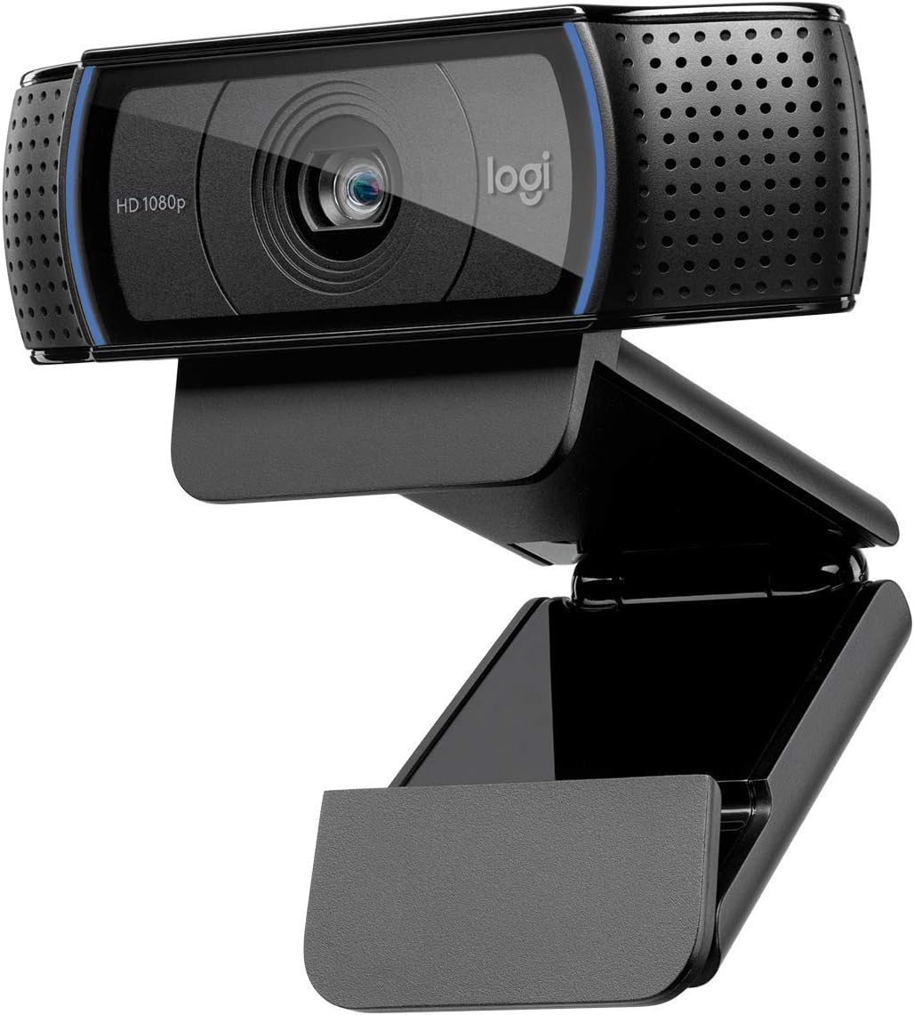

Really like that first webcam, because it appears to be really small, and easy to hide in a small corner of the room. However, would you happen to also know of a piece of Windows software that will allow for the motion-activated recording, and not just motion-activated pictures, like in Yawcam?

I'm working on a system using a low power motherboard (ASRock N3150M) and a couple of cheap webcams (Logitech C270). They say they only do 1280x720, but actually they do 1280x960 which I think would work well enough to see someone hauling all of your crap out of your room. I got 2 on sale $18 each online through Best Buy
