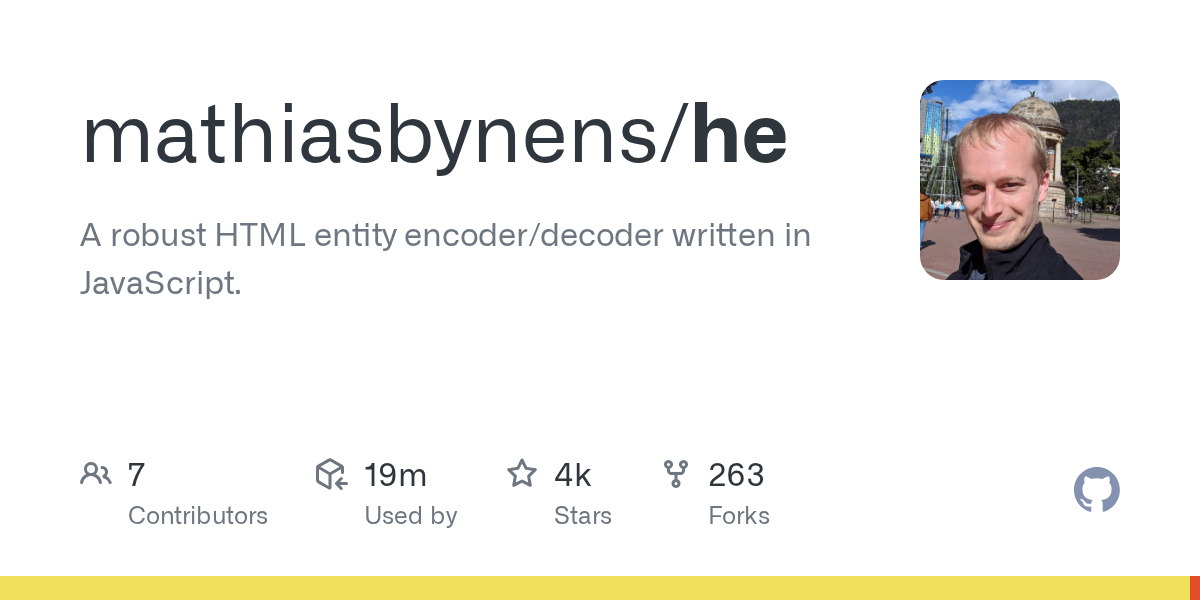

Anyway, I've gotta work with about 1,000 or so files of static content, and I wanna know if there's a pretty neat script, front end or backend that can fix any invalid entities, I've noticed from having checked some of the files, that they output the likes of: can’t as an example. I will not be going through each file, searching line by line for invalid characters.

Haven't tried this, but looks promising.
May as well give it a go aye? And only thing I've thought of trying is different char sets to be perfectly honest.

As for the encoder, I just ran the demo, and it seems to work just fine. The only concern I have is if it'll work before the browser tries to output the HTML, cause when you view the source code, it'll even display in there as can’t.
