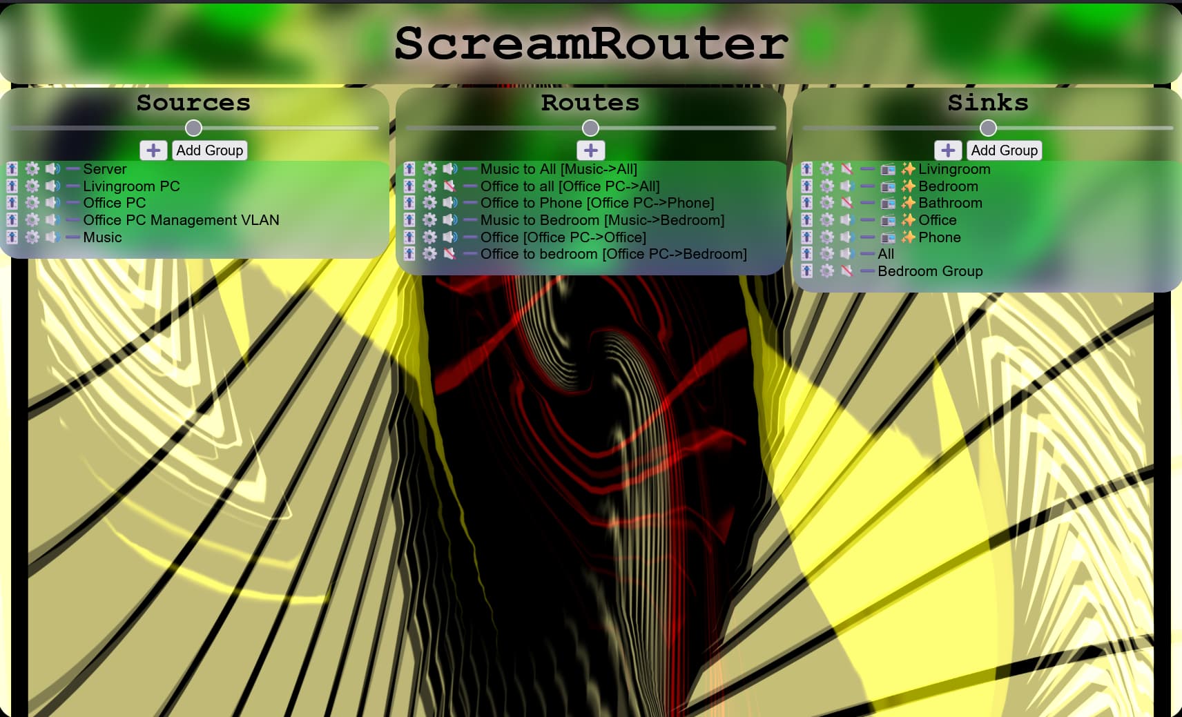

Hey. I’ve been a VFIO/Scream Audio Driver user for years. A few weeks ago I had an idea to make a mixer/router that allows configuring many to many sink<->source setups. After a few weeks this is what I have.
https:// github .com/netham45/screamrouter
(Remove the spaces, I can’t post links yet)

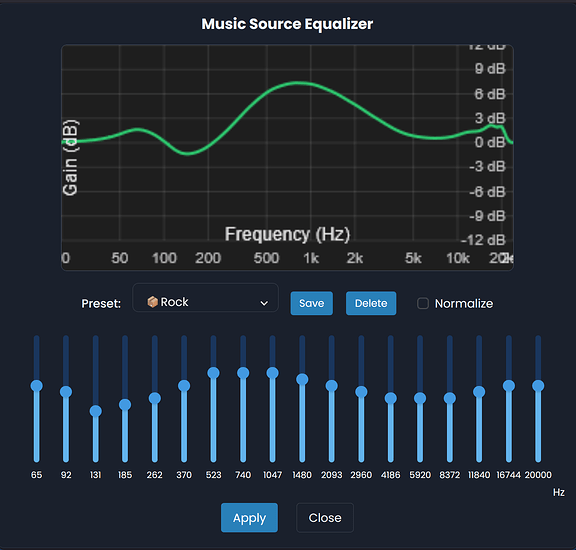

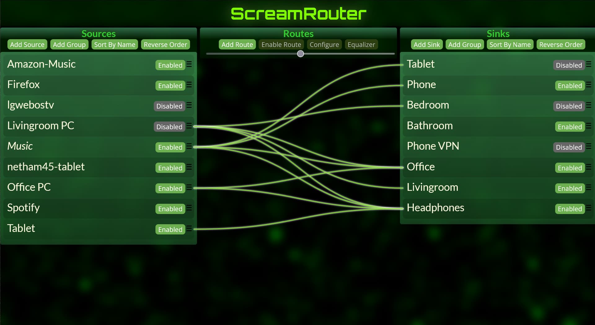

This allows routing of many<->many Scream sources to Scream renderers. It also allows adjusting equalization, volume, and audio delay. It uses ffmpeg to mix multiple sources together for a single output. It allows any source/route/sink to be disabled/enabled.
This uses Python Multiprocessing so it can be multi-threaded without worrying about GIL latency, and it uses Unix pipes a fair bit so it’s unix-like only. It’s designed to be able to support as many source to sink mappings as possible.
It is all configured over a FastAPI API with a basic first-draft interface. It also exposes sinks as MP3 streams that are available from the API or web interface.

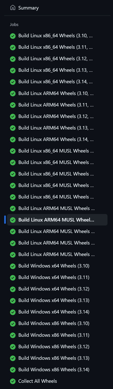

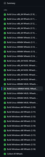

This should be resolved now, I also have aarch64 wheels getting built and uploaded to PyPI now.

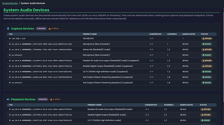

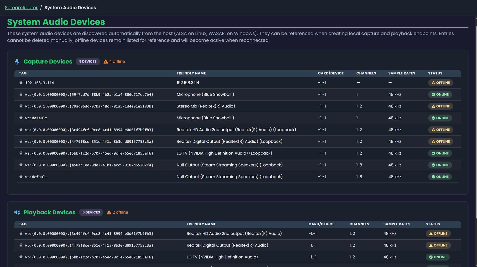

  • PulseAudio Emulation
  • ALSA and WASAPI support
  • WASAPI loopback capture
ScreamRouter can now capture audio from ALSA and WASAPI inputs, output to ALSA and WASAPI outputs, and provides a PulseAudio emulation layer so libpulse applications can directly play to ScreamRouter.

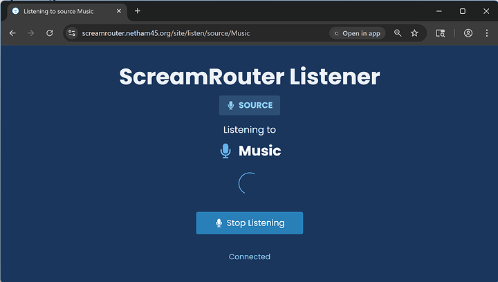

  • ScreamRouter can play low latency streams to WebRTC listeners through the Web UI
Packaging ( screamrouter · PyPI )
  • Set up GitHub build matrix to build PyPI packages for x86/ARM glibc/musl and windows x86/x64, install ScreamRouter with ‘pip install screamrouter’

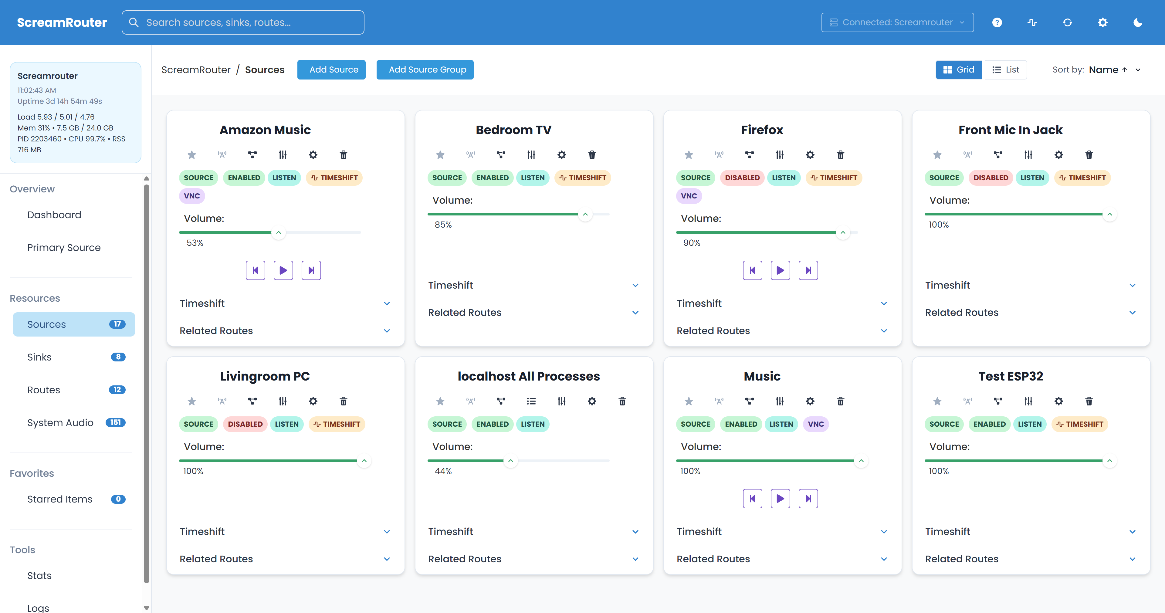

I’ve completely redone the UI since I posted here. I’ve rebuilt it to be a responsive React based site.
  • Main Site
  • Equalizer

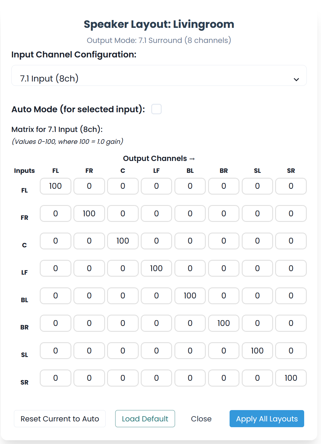

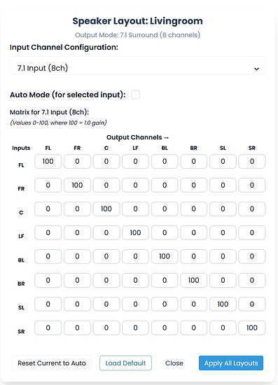

  • Speaker Layout

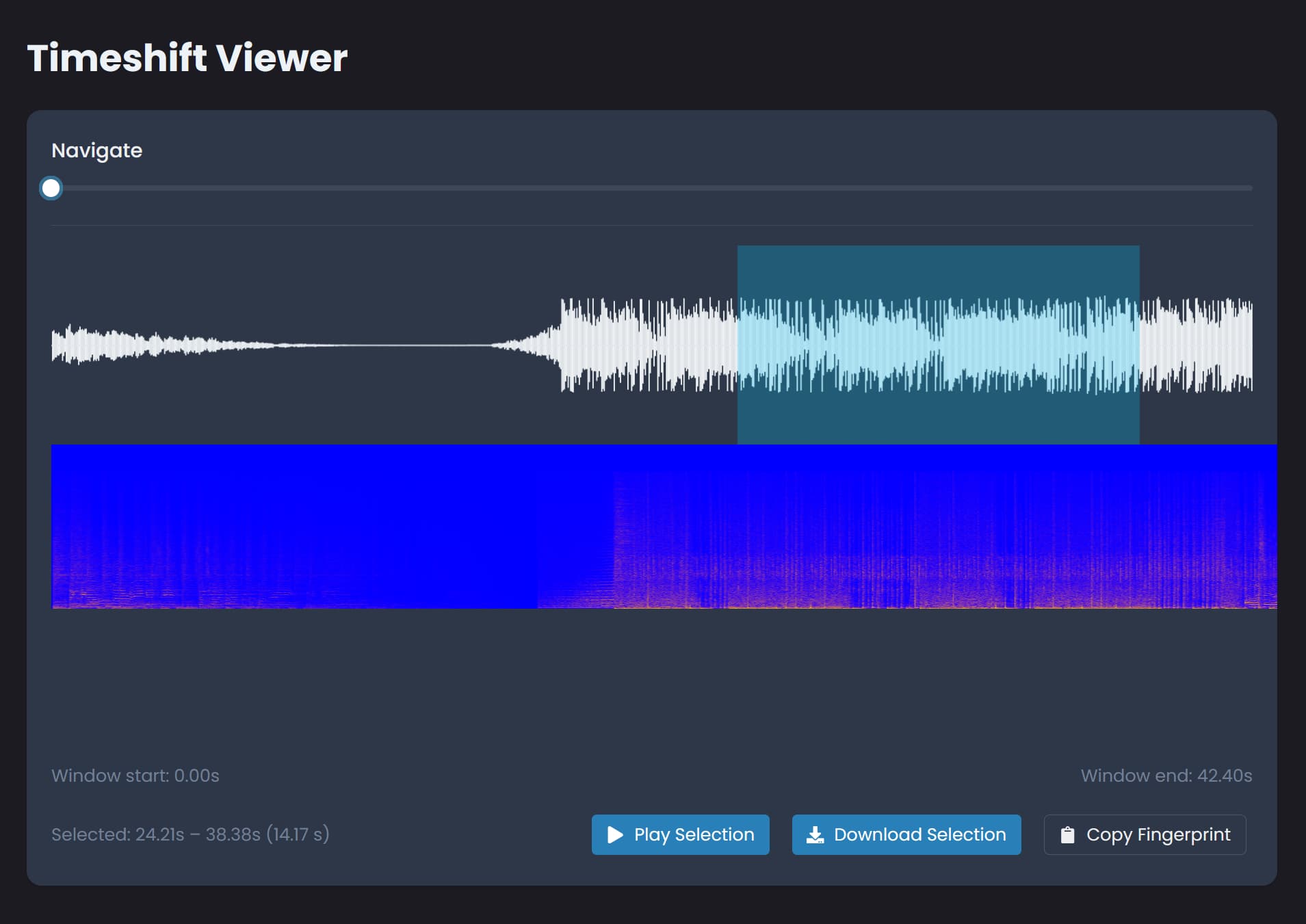

  • Timeshift Buffer Viewer

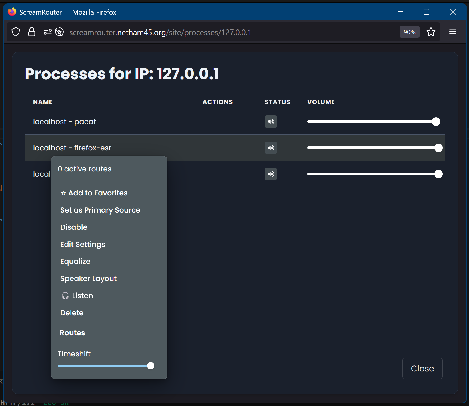

    • ScreamRouter keeps a 5 minute rolling timeshift buffer for every source and allows users to scrub them, delay sources, download the buffer or snippets as WAV files, or export fingerprints

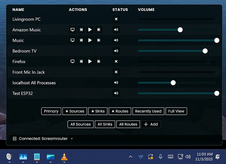

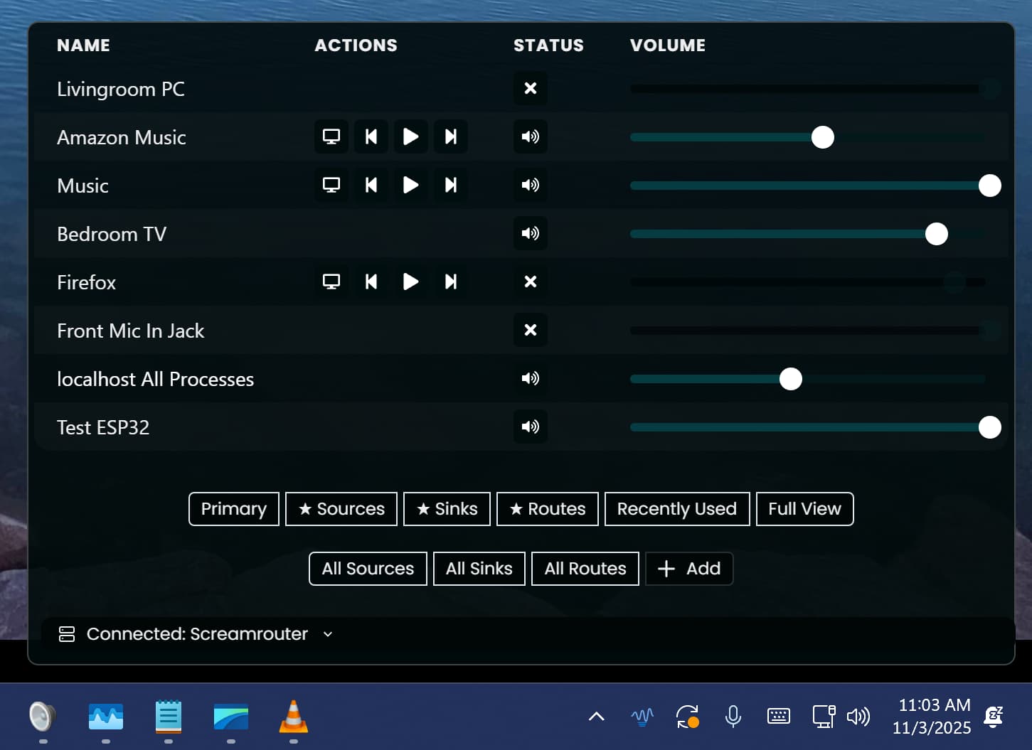

I’ve added a desktop menu that sits in the notification bar

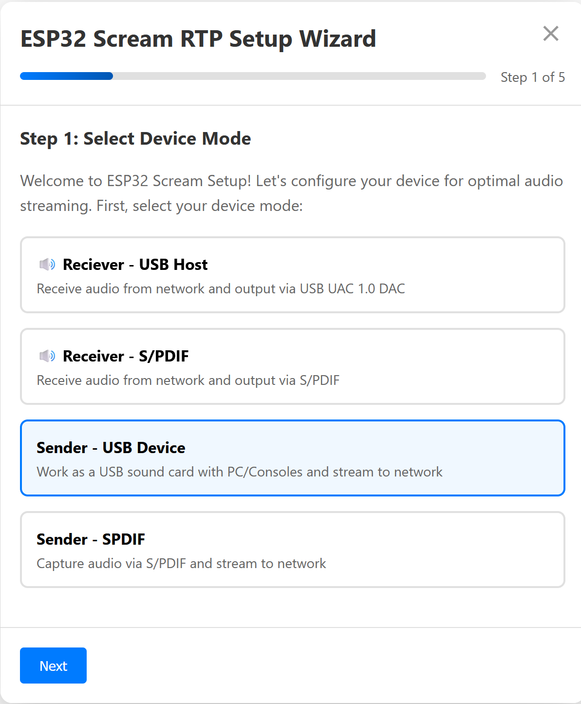

ESP32-RTP ( GitHub - netham45/esp32-rtp: This is an RTP sender/receiver that can receive network audio and play back over SPDIF/USB UAC Host or receive audio from SPDIF/or USB UAC Device and send it out over the network )
  • Created an ESP32 firmware for streaming to/from RTP sources
  • Supports acting as a USB sound card and playing out over RTP
  • Supports capturing SPDIF and playing out over RTP
  • Supports taking in RTP and playing to a USB UAC 1.0 device
  • Supports taking in RTP and playing out over SPDIF
  • Supports playing to unicast or multicast receivers, supports playing to/from PulseAudio, Pipewire, and VLC as well as ScreamRouter and other ESP32-RTP modules
  • Syncs time over NTP for playback synchronization
