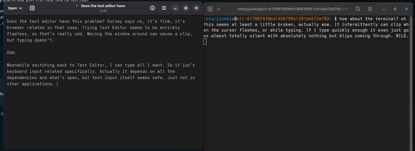

Right up until Fedora hit 6.15 mainline. Now it’s back to as bad or worse than I was seeing from the Navi cards. It’s a similar sort of issue as prior, where the audio clipping/stuttering is somewhat dependent on CPU load type. Initially I was rolling back to 6.14.9 to avoid it (and that was fully successful), but 6.16rc3 is a loser as is every 6.15.x release. It’s only affecting HDMI audio, but it’s source-irrelevant. Actually, it’s rather easily far worse than Navi had it on the rc kernel.

Having pavucontrol open seems like it may help, which is interesting. At first I thought it was down to having split something out to onboard audio, but after closing the UI for Volume Control it resumed skipping almost immediately, repeatably. Edit: Actually, only if Volume Control is visible it seems.
