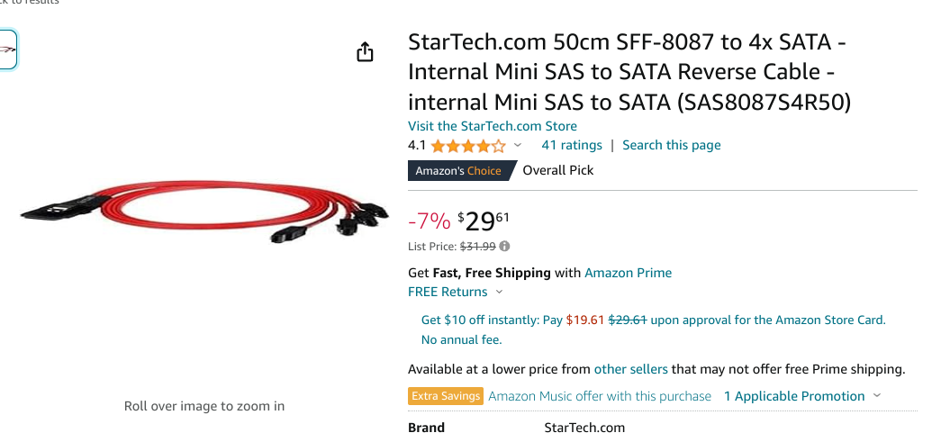

After doing some digging on the topic, your motherboard you have mentioned only supports 4 drives off of the SlimSAS port. This is a limitation of your chipset, because SAS/Sata ports have been slowly declining on motherboards. you can use a SlimSAS 4i to Sff-8087 for 4 ports of Sata on the front of your system.
You can also purchase a reverse breakout cable to go from 4x Sata to 1x Sff-8087 port to gain functionality of all 8 bays on the front of the chasis. YOU MUST GET A REVERSE BREAKOUT CABLE
The length of the cable+pcb routing for the sata connections MUST be under 1M, unlike SAS that is rated for far greater lengths.
I think you can make your chassis work, but you will need to get creative with any other storage. You could also consider getting an 8 port internal HBA and leave you with extra internal ports.
