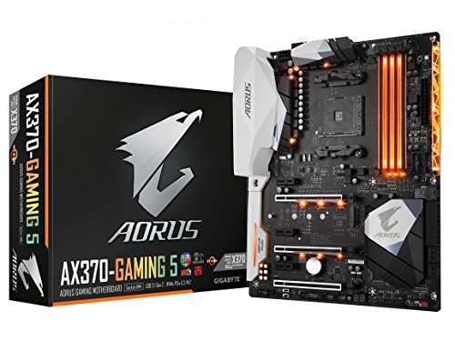

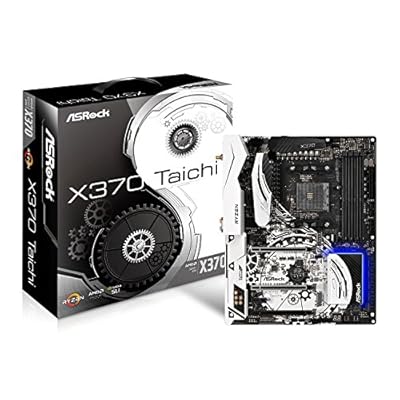

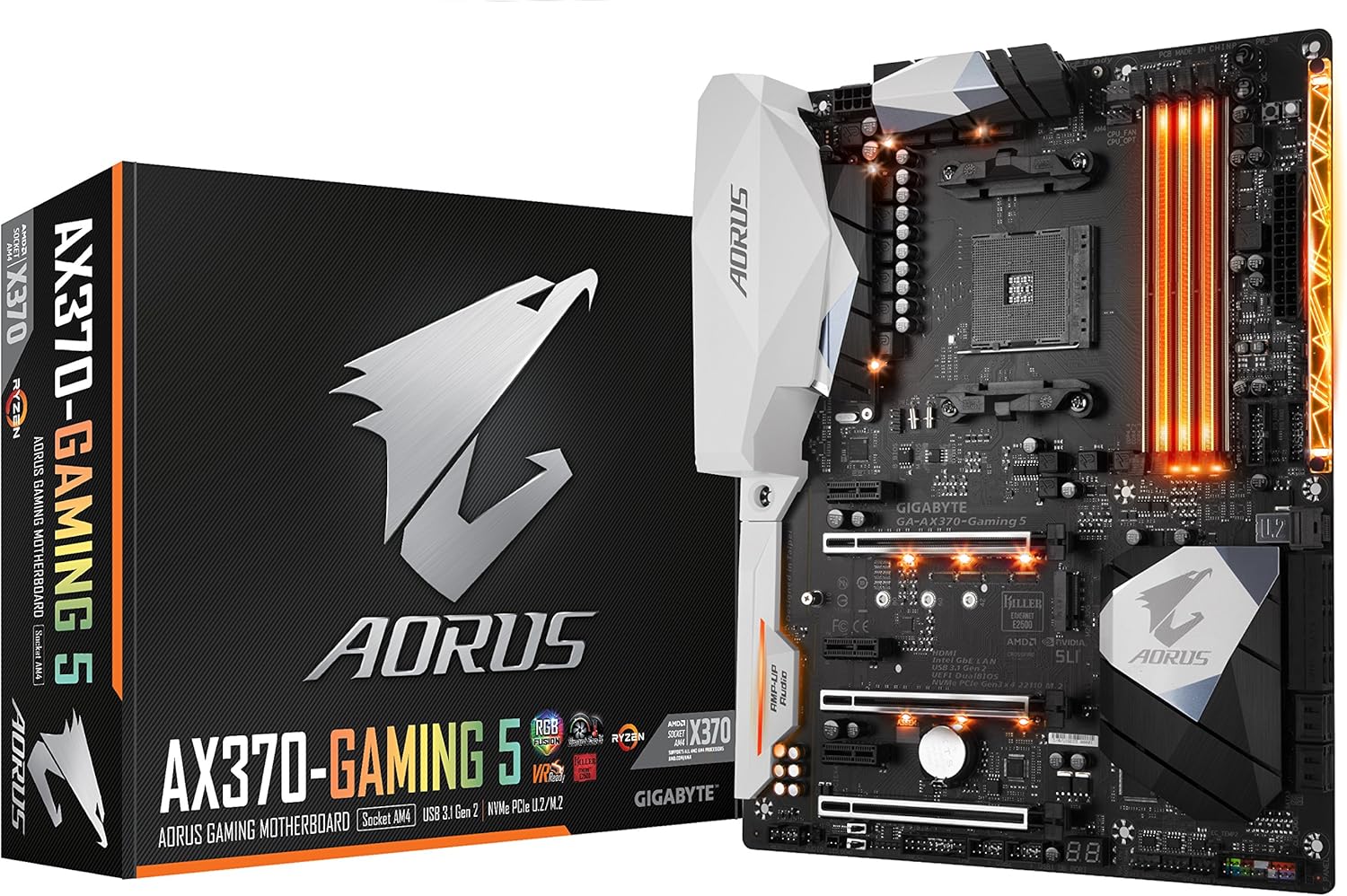

Recommended Motherboards.
A Ryzen 5 1600, 1600x (6 core) or any Ryzen 7 CPU is an ideal paring for this setup. Be sure to check out our motherboard reviews for the full rundown.
While I haven't actually tested running a VM yet, I can confirm that on the Asus Prime X370-Pro with the latest AGESA 1.0.0.6 UEFI that graphics cards show up in isolated IOMMU groups.
