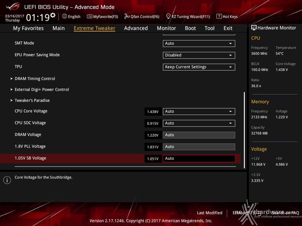

Closest I can find for Crosshair VI hero(I recon thats actually a intel mobo since baseclock is called BCLK rather than APU on the side):
According to the reddit screenshot you posted the SenseMI features would be in that part of the bios if scrolled further down. So see if you can find Extreme(or Ai) Tweaker - Tweaker's paradise, if not then asus must have reserved that for the higher end CH VI Hero mobo to differentiate it from the lower end x370 mobos.

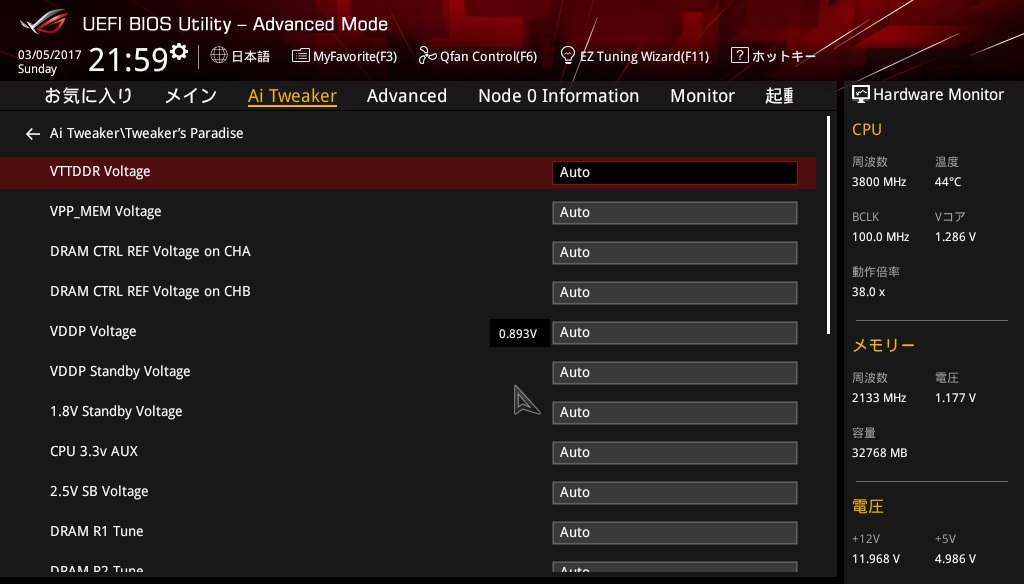

edit there it is on CH6(next after External Digi+ Power Control):
and then scrolling down in tweaker's paradise:

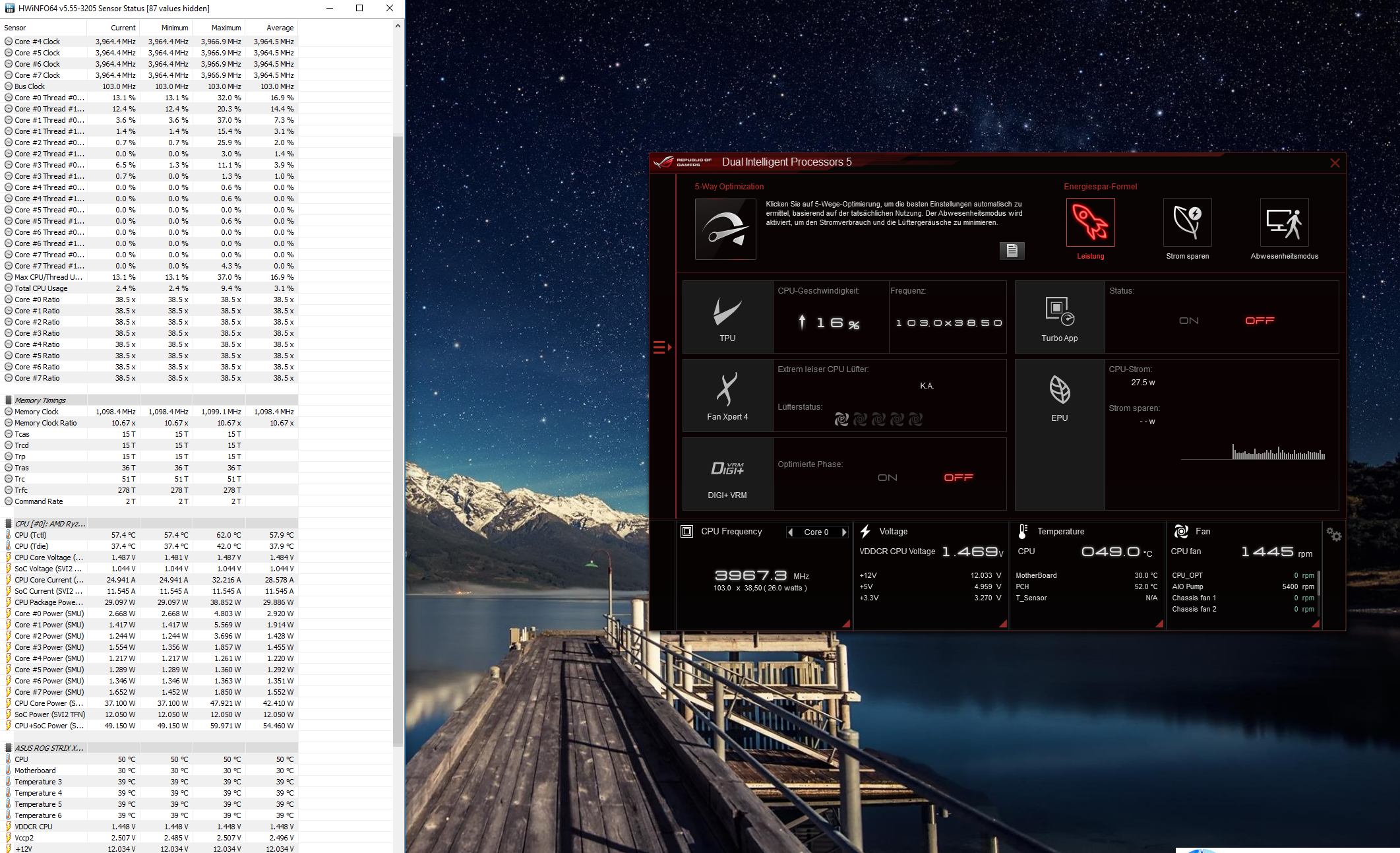

So I used the asus ai suite tool to oc the cpu with it and now it shows temps what???
It's showing the right temperature ayy D
I installed asus ai suite did the OC with the tool and it showed the right temperature then I looked what it set different it is the !CPU 1.80 V VOLTAGE ! setting if it's changed to 1.900V the cpu is showing the right temperature
