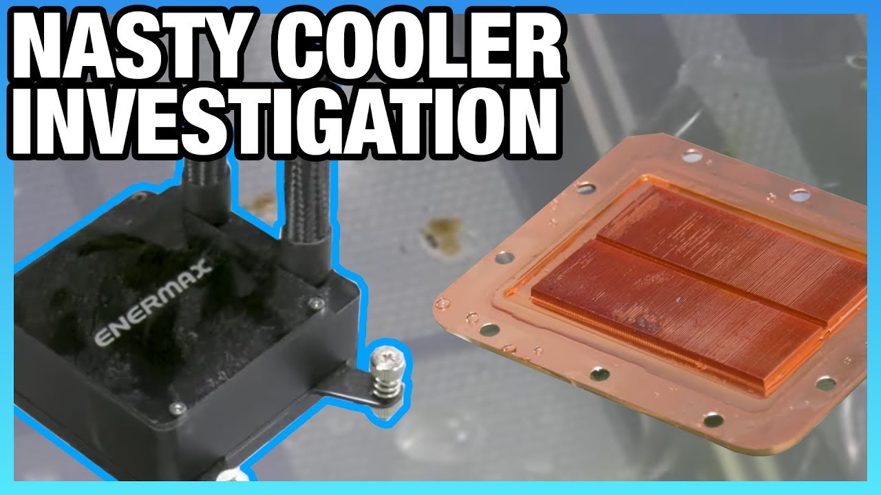

I’ve been doing a bit more research, and as what @diizzy also mentioned, the VRMs and as well as for the CPU, air cooling is going to be tricky.
I’m REALLY not comfortable with a custom loop for water cooling but I wouldn’t mind a all in one liquid cooling solution and I found 2 contenders:
Enermax Liqtech TR4 II 360 Addressable RGB AIO CPU Liquid Cooler
or
CORSAIR iCUE H170i ELITE CAPELLIX Liquid CPU Cooler
Anyone has experience with these 2?

If you must go TR then might be worth it to wait a couple of months, there is rumor that AMD will soon announce a Zen 4 TR which might run cooler than your current lineup.

i would avoid all enermax liquid coolers. they had quite a lot of issues with gunk up and i wouldn’t trust a new one from them if i HAD TO get an aio.
i mean you’d have to hold a gun to this head to get me to get one over an aircooler, but gosh darn it, i wouldn’t get the enermax one :smiley:
(gn video about gunk up problem)
