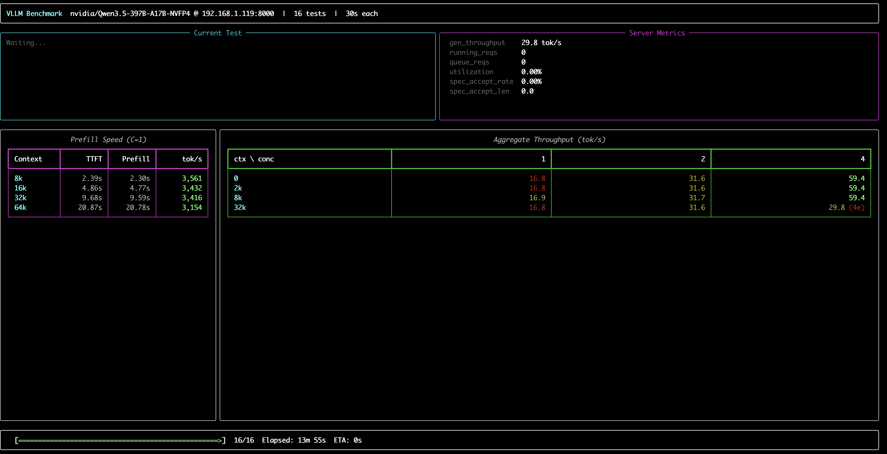

I’ve got a 4-node cluster (3x ASUS GX10 + 1x Dell GB10, all Grace Blackwell with 128GB unified memory each) running Qwen3.5-397B-A17B-NVFP4 — a 397 billion parameter mixture-of-experts model with 17B active parameters per token, quantized to NVFP4.
Nodes are connected via 400GbE RDMA using a MikroTik CRS804-4DDQ-hRM switch. Serving with vLLM using tensor parallelism across all 4 nodes. Here are the llama-benchy results:

Notes
  • Generation speed is consistent ~17 tokens/sec.
  • Prompt processing seems to scale ok (541 t/s at 128 tokens, 2,200+ t/s at 8K tokens)
  • Time to first token is sub-second up to 2K token prompts, ~4 seconds at 8K tokens (I need to look at what was happening here more closely, I believe there were instabilities)
  • 128K context window, `–enforce-eager`, FP8 KV cache
  • CUDA graphs are disabled (`–enforce-eager`) because capturing them requires pre-allocating memory buffers that don’t fit alongside the model in 128GB unified memory — Claude tells me to expect ~20-30% throughput improvement once this is resolved
  • Using `VLLM_TEST_FORCE_FP8_MARLIN=1` to force Marlin kernels for NVFP4 quantized weights as the default kernels don’t support SM120 (Blackwell) yet
  • Engine crashes at larger prompt + output combinations (8K prompt with 512+ output tokens)

@datagaucho which vllm benchmark tool are you using?
Have you tried the `–enable-expert-parallel` option? Ref: Expert Parallel Deployment - vLLM
You could likely increase PP or TG if you went with a disagg structure, depending on what you find more relevant, given that this model should fit in 2 of your Sparks.
