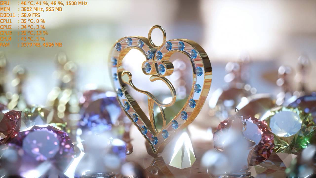

We’ve already started seeing efforts from developers implementing raytracing without the reliance on dedicated proprietary hardware. This demo runs on Vega 56.

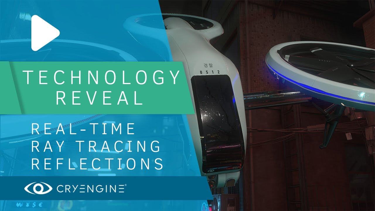

What I mean is that there is no need for the dedicated hardware. Crytek and now foolishly nVidia themselves have proved as much. It is not going to be fast, new stuff never is but now it is known that this is just software and does not need the RTX stuff at all.
I am interested to see now how the preform, and if anyone will do a comparison of the nVidia DXR stuff compared to just native Crytek. If the Crytek one runs at a reasonable speed or in any way faster than any of the nVidia stuff on the 10 series stuff they will have shot themselves in the foot by outing that their solution was just software designed to sell overpriced cards, when it could have been just software all along.
Hold on there. The scene in crytek’s demo was almost entirely static. You could do most of those reflections with old school environment mapping. We simply don’t know what shortcuts they’ve taken to make any conclusions.
It sure looked impressive, but from a technical standpoint they didn’t give us much to work with.

Crytek on the other hand has shown very little and is not doing path tracing. We simply don’t have enough information to go on right now.
