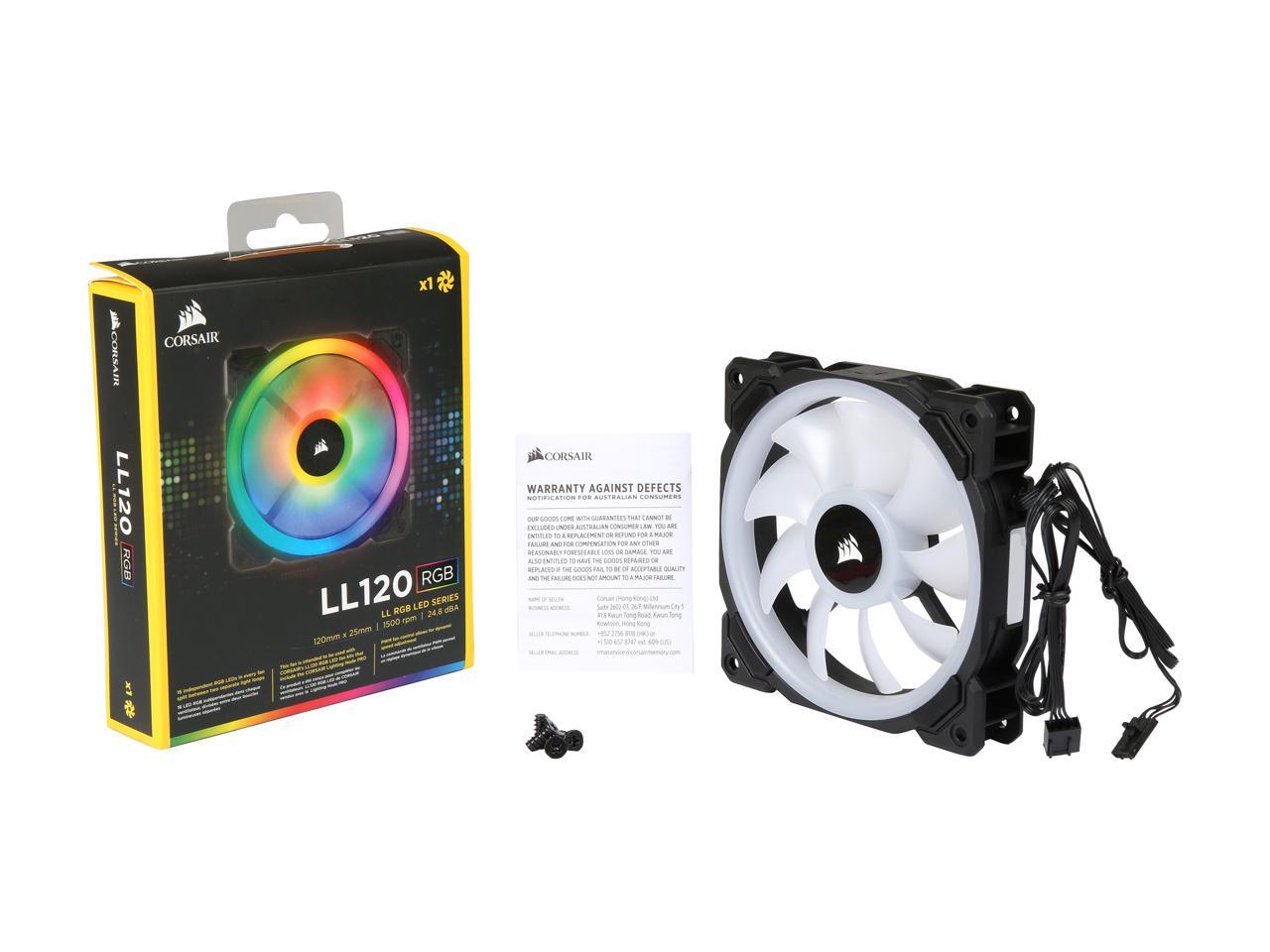

I believe this is all of them, since they would need separate connections for RGB vs PWM fan power.
Maybe the lowest end ones just cycle… but I believe that Corsair, ThermalTake, etc. all have separate control. More cables to manage though.
You can see two distinct connectors on the Corsair LL120 here:
