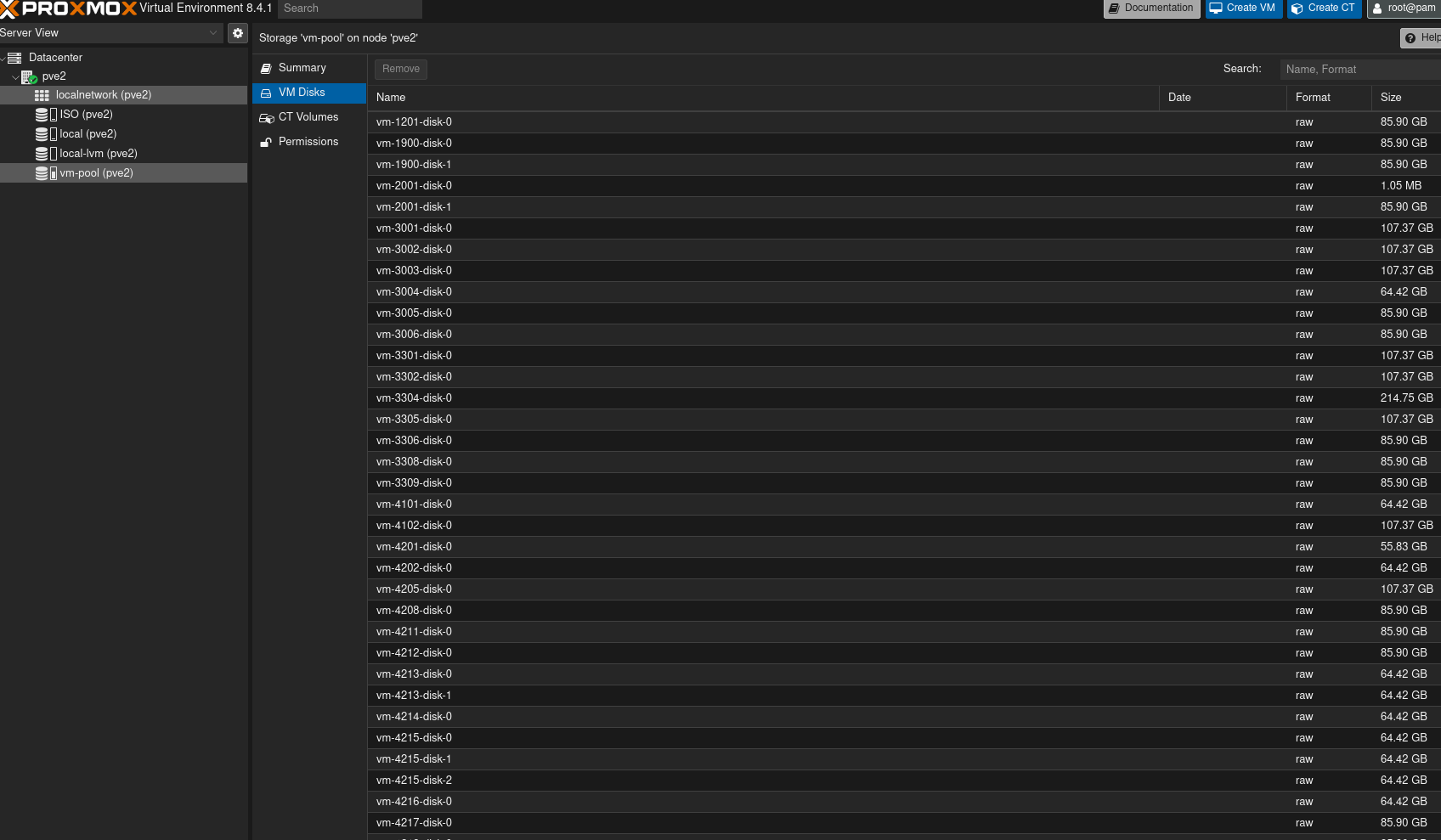

Even though the files show in the list, and I can see the files after mounting the ZFS pool, I cannot move the data across. If i look at the mount points, the data is not showing up…
I am kinda stuck because I am not sure what to do next and every document I have found does not show a direction to resolve this issue.

If I do a zfs list I get the following and can see in the Web UI:

vm-pool/vm-9009-disk-0  20.3G  2.13T  14.2G  -
vm-pool/vm-901-disk-0   3.85M  2.13T   108K  -
vm-pool/vm-901-disk-1    246G  2.26T  41.8G  -
vm-pool/vm-9010-disk-0  20.3G  2.13T  11.5G  -
vm-pool/vm-9011-disk-0  8.13G  2.13T  1.21G  -
vm-pool/vm-9012-disk-0  12.2G  2.14T  2.10G  -
vm-pool/vm-9013-disk-0  23.2G  2.15T  2.88G  -
vm-pool/vm-9014-disk-0  89.4G  2.20T  8.04G  -
vm-pool/vm-9015-disk-0  13.2G  2.14T  2.09G  -
vm-pool/vm-9016-disk-0   106G  2.21T  24.3G  -
vm-pool/vm-902-disk-0      3M  2.13T    96K  -
vm-pool/vm-902-disk-1    102G  2.20T  25.7G  -
root@pve2:/vm-pool/images#
but cannot select the file when building out the VM or the directory I save the config files in…
That is very strange. Based on this you should be seeing your files in /mnt/temp.
It looks like it is properly mounted.
Maybe the backup failed for some reason? Or you inadvertently copied them to a different location?
Did you verify the pool was actually mounted before you copied the files to the temp folder?
I don’t know what to suggest at this point.
Just in case the permissions and ownership are wacky, can you try becoming root and see if you see anything then?
