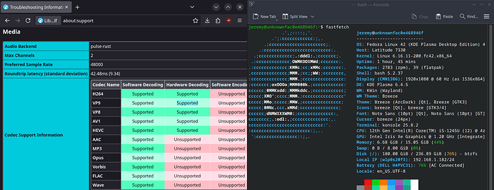

The problem with Fedora is that for the life of me I couldn’t get any sort of hardware encoding/decoding to work (I found out my browser, LibreWolf, was only using software decoding). After weeks of stumbling around, reinstalling packages, and going as far as manually compiling/installing packages (and dependencies) from source (and failing as the Intel Media Driver didn’t want to build on my system), I figured out the issue: Fedora uses an atypical driver install path for the Intel Media Driver.
Based all the documentation I could find, the driver path is expected to be /usr/lib64/dri/iHD_drv_video.so but Fedora installed it to /usr/lib64/dri-nonfree/iHD_drv_video.so. So one symbolic link later everything magically works! With the packages I found in the repos no less! The cherry on top: VP9_QSV is faster under Fedora than in Win11 (38FPS vs ~30FPS). And LibreWolf reports hardware VP9 decoding as available! Hopefully that will be a boon to my battery life because I was slightly disappointed by battery life.
