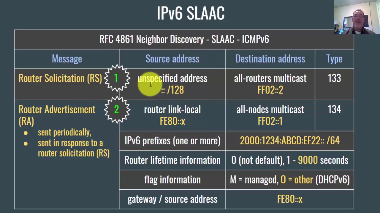

In only the first minute he already made sense of how/why the clients come up with these bizarre random addresses after the 64 bit network/subnet portion. Will definitely keep watching.
The manual displays a series of IPV6 relatedtabs, but then there’s no explanation for them. Spectrum should be able to assign to your LAN a delegated prefix, size 56, you should look into your router tabs for the settings on the WAN side to use dhcp, and settings on the LAN side for a /56 delegated prefix … if all goes well and your LAN interface on the router gets an IPV6 address, all your LAN attached IPV6 devices should start getting IPV6 valid addresses through router advertisement , there’s no need to set up static IPs and/or DHCPv6 …
I’ve just sat through more of the video and he explained how SLAAC basically has the client assign itself an IP.
For my purposes here SLAAC was an option during OS installation and just like he said all it does is convert the 48-bit MAC into a 64-bit string and that becomes the client IP.

I’ll have to test it to see if it works but SLAAC might just be the answer I was looking for. I’ll have to configure a new DNS Server instance and test it.

When using SLAAC, the first 64 bit of your IPV6 address need to be routed (i.e. there’s no NAT involved), so yes, you or better, your router, need to talk with your ISP and ask, out of the /56 prefix delegation, a single /64 subnet to be allocated for your LAN.
Once your router is given that, it can then advertise that first /64 bit prefix on your LAN (different than DHCP where the whole ip addresses are handed out) and your clients will grab it, couple it with your 64 bit generated device identifier, and assign themselves a valid (routable) IPV6 address.
You can then configure (either through dhcp if your router allows it or manually) the IPV6 DNS forwarding IPV6 IPs in your clients and you’re good to go.
