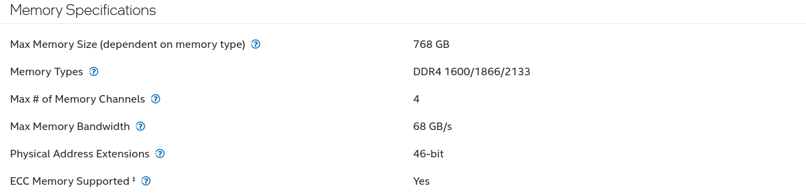

Your board supports Xeon v4 CPU’s and 256 GB of DDR4 ECC UDIMMS
For a NAS, I’d strongly recommend swapping RAM and CPU but this is a fantastic MoBo to start with.

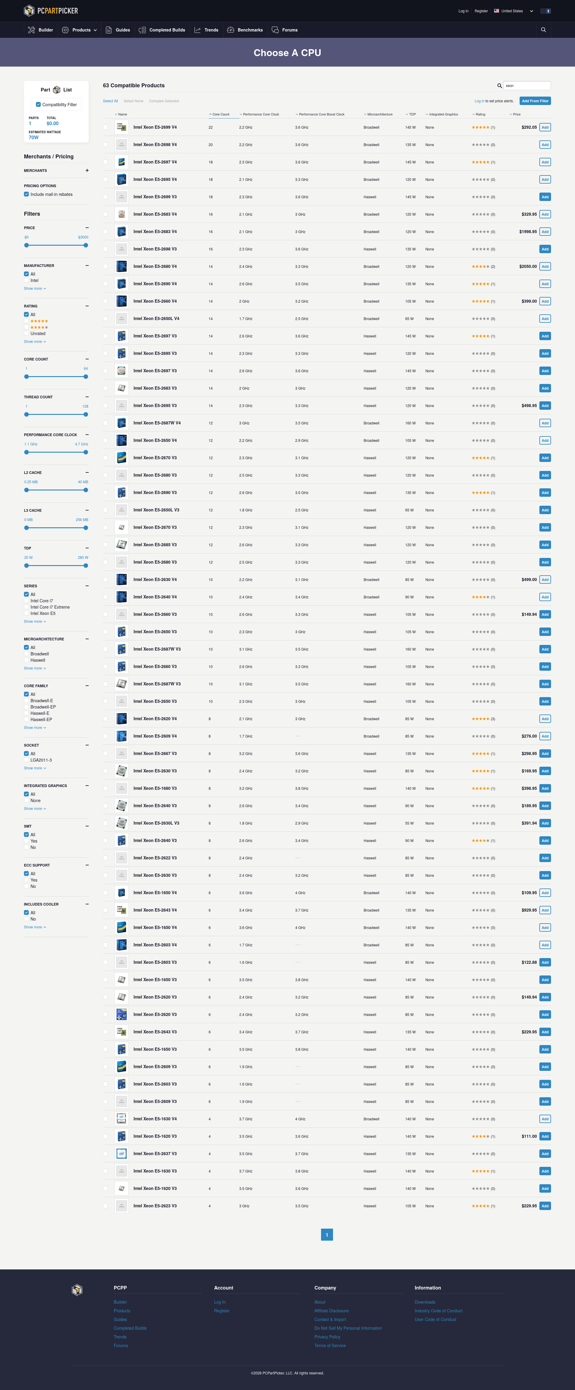

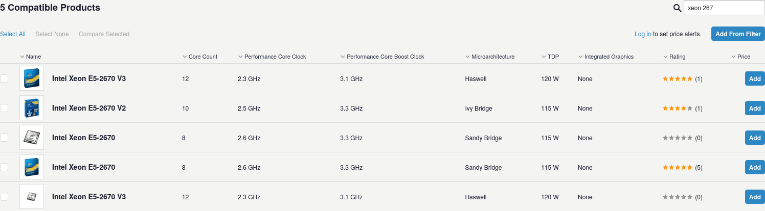

5820K
9839 / 140 = 70
That is incredibly low…
E5-2650L v3 or E5-2630L v3 or E5-2696 v3
First one is 25% faster
second is 25% slower
third is 25% faster and 25% slower per thread
happy hunting

  1. No, but it depends on how much you value your data. In my (6+ years ago) experience ZFS would panic rather than corrupting data with faulty memory but it might not always be the case.
