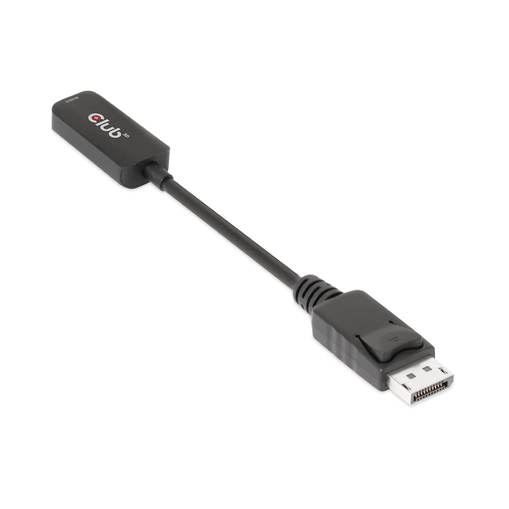

Please recommend a display port to hdmi cable. The club3d link in the help section links to a dp to dp cable and can only find a long club3d dp to hdmi cable. Tried a cable matters adapter, cable and a SWITCHFLUX do to hdmi. Trying to run an lg oled c3 at 4k 120hz. Thanks in advance!

Hmm so do you want one just shorter? These adapters worked when I tried them:
Can confirm that adapter works at 4k120hz
