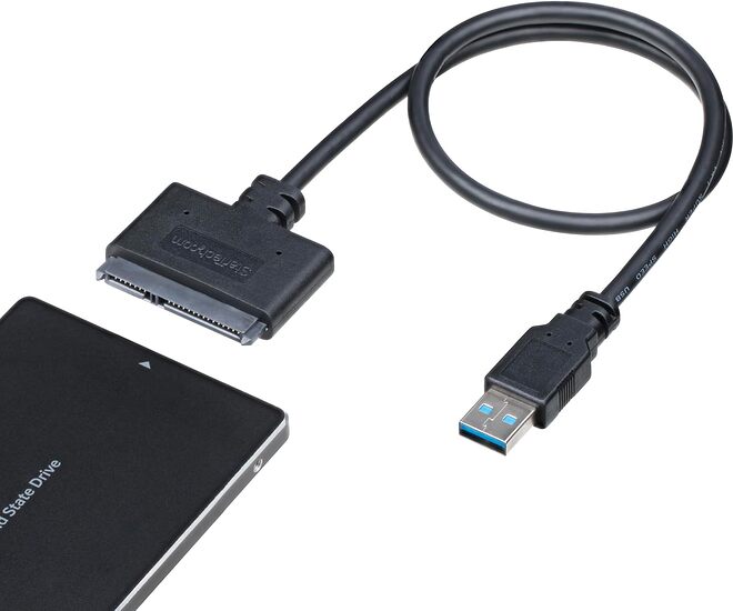

You can install TrueNAS on a USB SSD (not a thumb drive).
Something like this:
With something like this:
Amazon.com: Kingston 120GB A400 SATA 3 2.5" Internal SSD SA400S37/120G - HDD Replacement for Increase Performance , Black : Electronics
or something like this, with the drive that’s already in the M.2 slot preinstalled with TrueNAS:
Amazon.com: SSK Aluminum M.2 NVME SATA SSD Enclosure Adapter, USB 3.2 Gen 2 (10 Gbps) to NVME PCI-E SATA M-Key/(B+M) Key Solid State Drive External Enclosure Support UASP Trim for NVME/SATA SSDs 2242/2260/2280 : Electronics
Then it’s just a matter of changing the boot order to boot from USB rather than an internal drive. This will free up that internal slot for some data caching drives.
