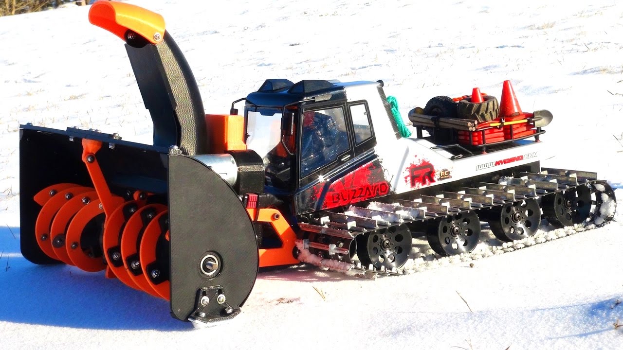

Treads I didn't think of that. That might be better than wheels actually.
Saves you the hassle of the steering mechanism. Just use one motor per track.
yeah thats true. looks like Ill need another motor and esc tho
