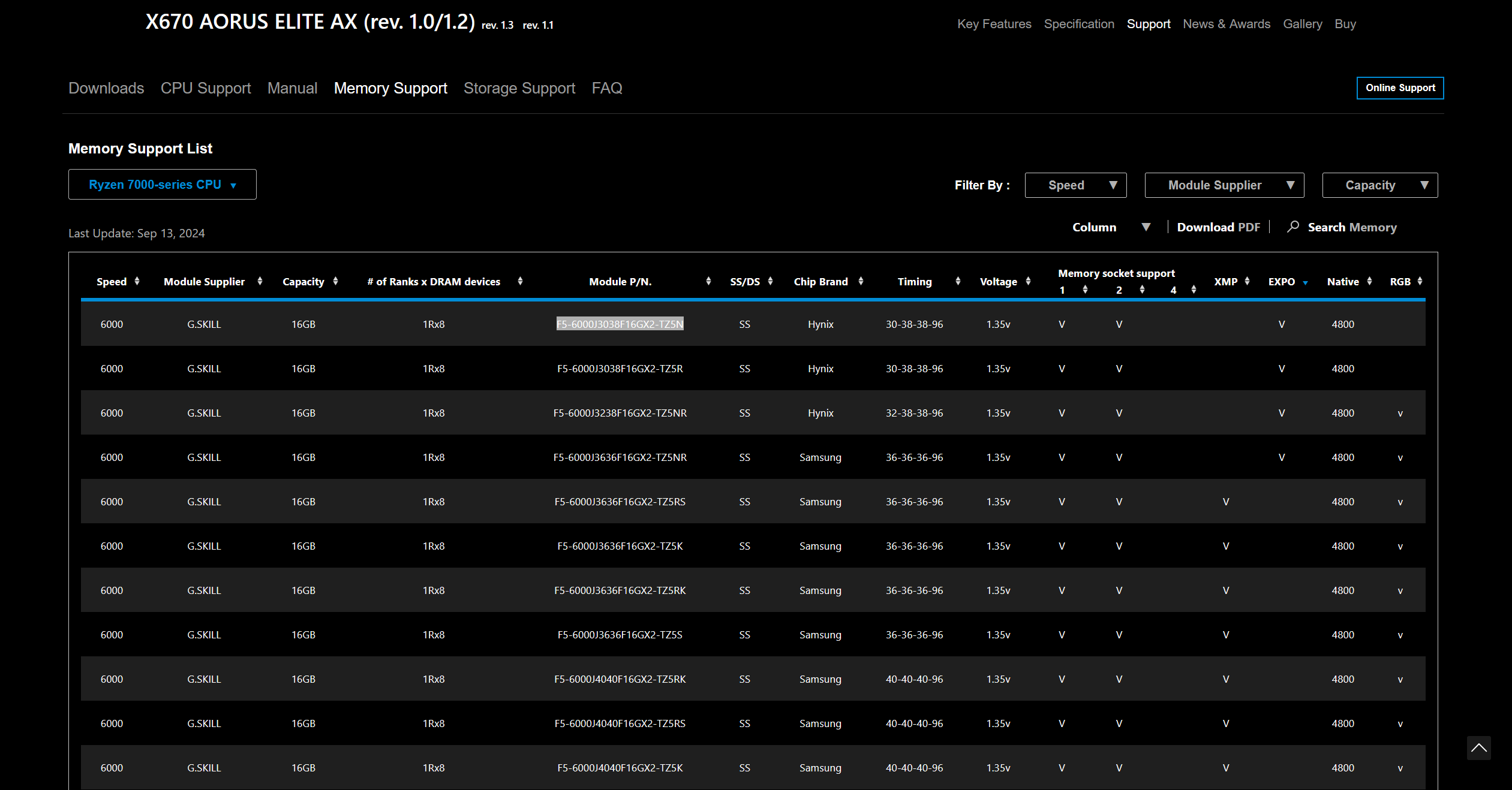

I guess my real question is now, what should I get as a replacement? What I should’ve done is checked the official compatibility form, which you can see here: which shows F5-6000J3038F16GX2-TZ5N as compatible, whereas the ram currently installed is F5-6000J3038F16GX2-FX5, which isn’t on the list.
So is it REALLY so different? they both have identical timings. Barring bad ram, which I’m finding more difficult to believe since it’s been hours on a 5200 overclock and no problems whatsoever, what’s to say this CPU just can’t handle 6000 with 32gb?
It’s very confusing. Like @GigaBusterEXE said, 6000 worked fine on my other kit, so ideally that’s what I want. Should I be prepared to settle for 5200? Is there any data on the 7900X3D memory controller being bad with this amount?
But G.Skill has the X670 Aorus Elite AX on the F5-6000J3038F16GX2-FX5 QVL. :upside_down_face: QVL just means a combination worked with the parts the manufacturer had for testing, not that it’s so far inside the tolerance envelope all combinations of the same parts will work.
I’m fairly comfortable assuming TZ5N and FX5 are slightly different heatspreaders on what’s otherwise the same assembly.
