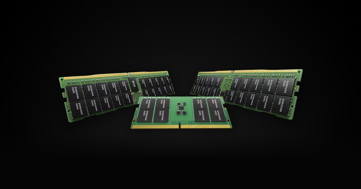

Use ECC Registered DIMMs (RDIMMs)
I use 256GB (8x32GB) DDR4-3200 PC4-25600 2Rx8 ECC Registered DIMMs with no issues on my WRX80. They’re DDR4-3200 native, so XMP does not apply.
Preferably use a known manufacturer like Samsung or Micron. I don’t know about Nemix.
Mines are genuine Samsung DIMMs.
Use Samsung’s DIMM search utility to find exact part numbers:
Mine is M393A4G43AB3-CWE
