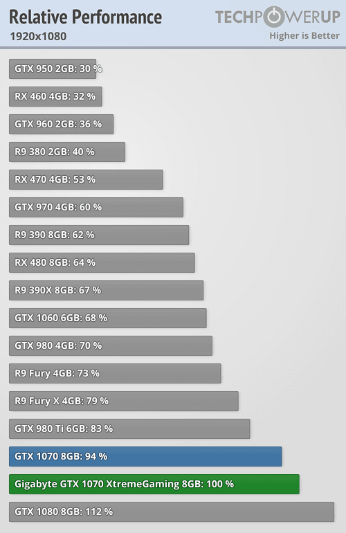

Well the fury is some 10-15% behind 1070 overall performance stock for stock... It's also some 15-20% ahead of 1060 for the same price....

Notice, however, that the 4K performance difference is actually smaller than the 1080p...

Those statistics tell nothing. What game? Settings? Rest of the system? What is that?
Sorry got a little of that from that phrase and a lot of people on here seem to think that.
It's this review... Overall performance between all the benchmarks they have made...
Mainly DX11, because they are too lazy to benchmark DX12 properly...
And also because most DX12 games (the few that exist) run like shit with little to no benefit on higher end hardware.
