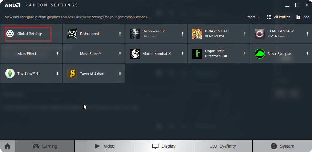

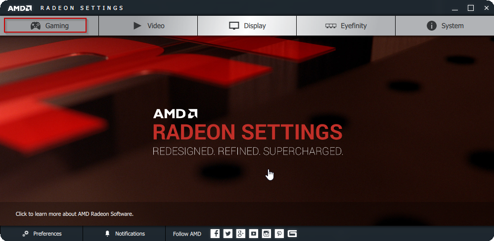

go into Catalyst and be sure the power usage is set to +20%. I used to have a very similar problem. may solve it for you.
Do you know how I could do this with Crimson? Catalyst Control Center has been phased out :/

Ah I see, thank you for the detailed reply! So I should set it to +20% yea?
something to try, yeah. Was a problem on one of my older cards.
