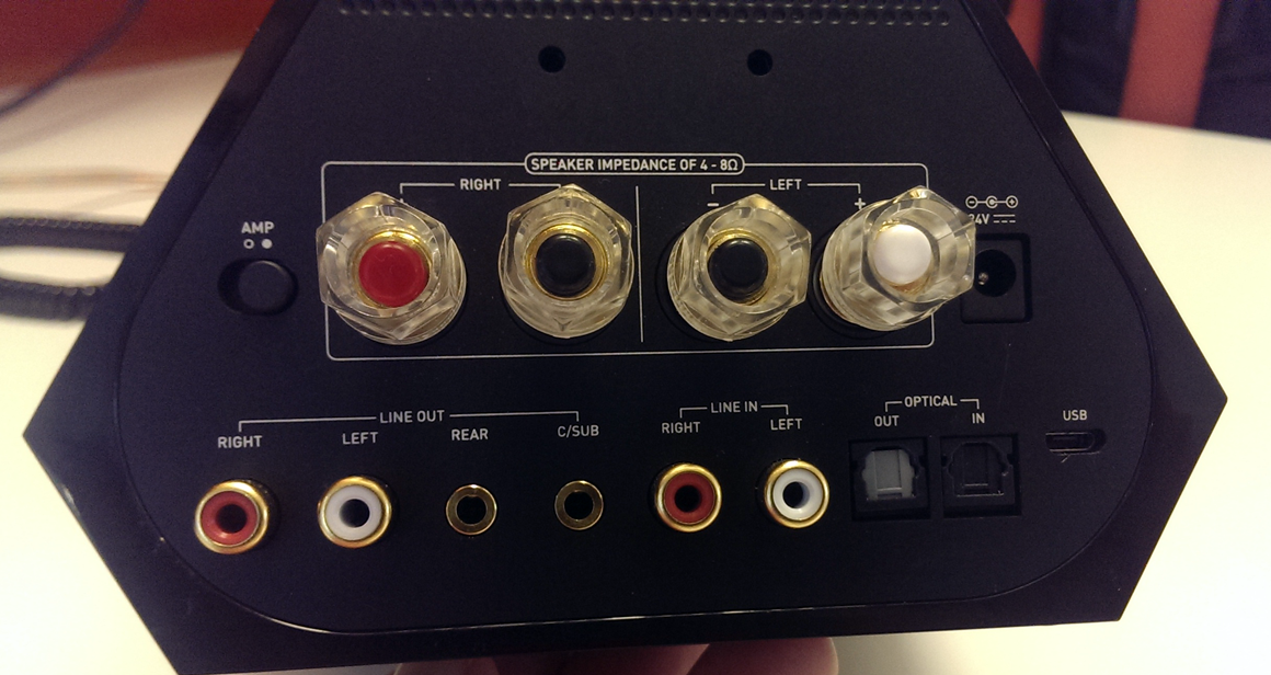

If it's an external DAC the chances of PC electromagnetic interference is lowered significantly to none. If you're connecting your Sound Blaster X7 through optical cable or USB, the only thing it should be carrying is the digital signal of the sound, nothing more, but if you're connecting it with an analogue connection using 3.5mm output from your mobo to the 3.5mm input to your DAC/Amp combo, the signal of the EMI from PC will carry.

It takes in optical, so it can work on almost anything with optical out which all consoles use, and most PC mobos have an optical out, not only that but you can use it with heaphones or speakers. This is a universal and flexible device, for most mainstream consumers this is more than what they'll ever need.

This has a wallwart for 24v.

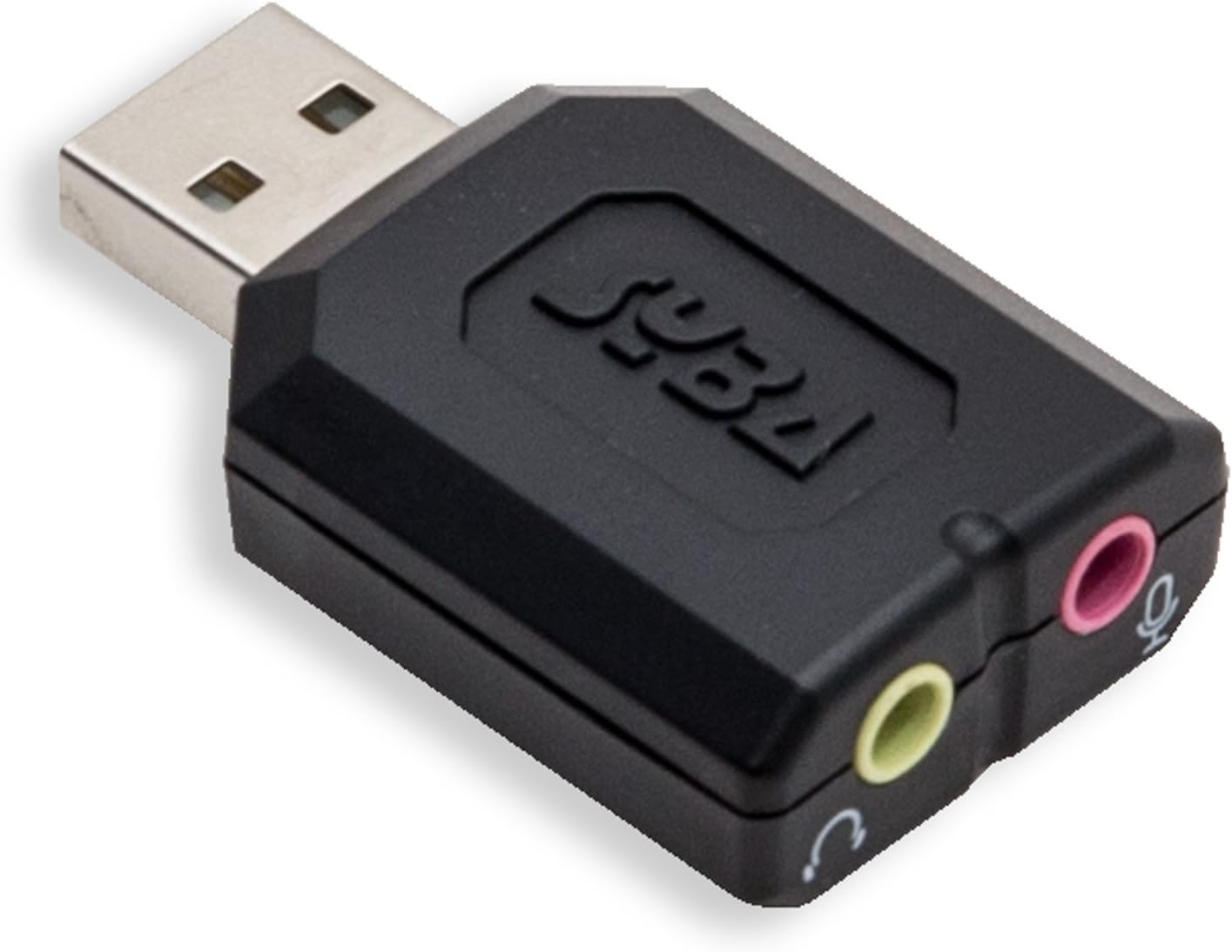

Have you ever used one of those cheap USB audio adapters? They should clear up static if it's caused by EMI coming from your power devices. Computers and chargers are wicked noisy in terms of EMI, so it's pretty normal to hear static when headphone/audio cables are near them.
