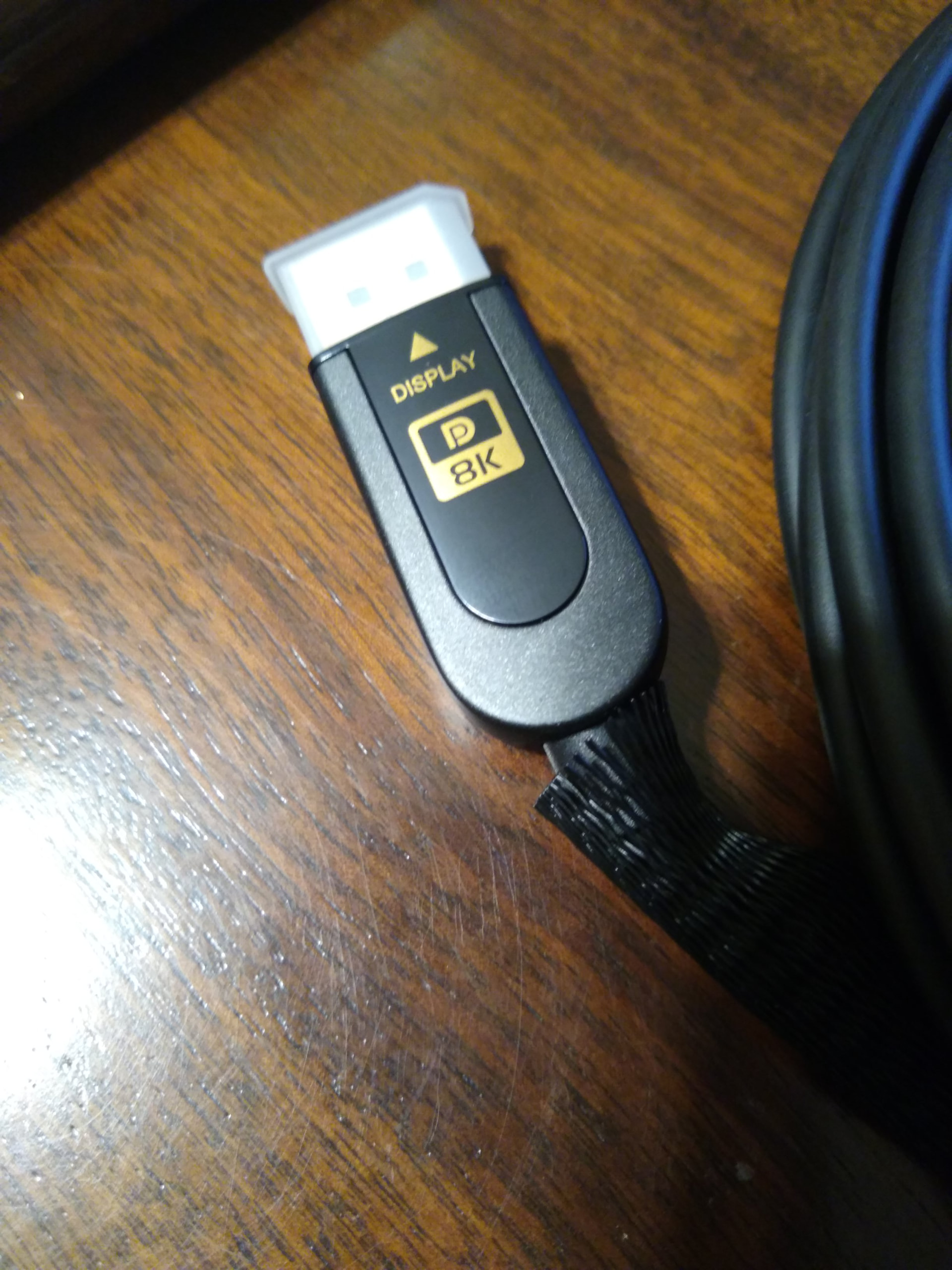

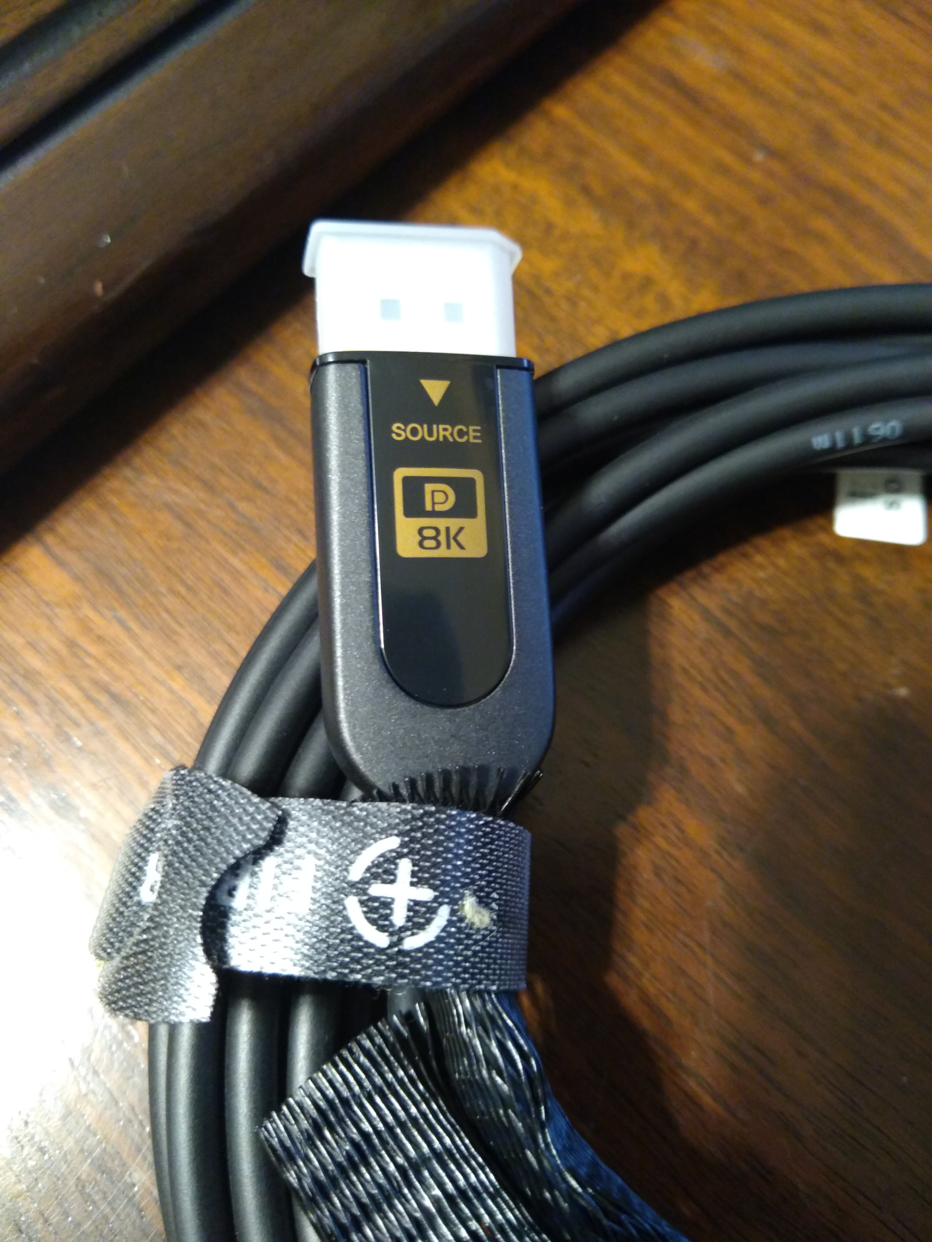

Weird yes I can confirm those are not fiber optic. Fiber optic cables will have a “source” and “display” end. They’re not bidirectional. If they lack this they are definitely not fiber optic.

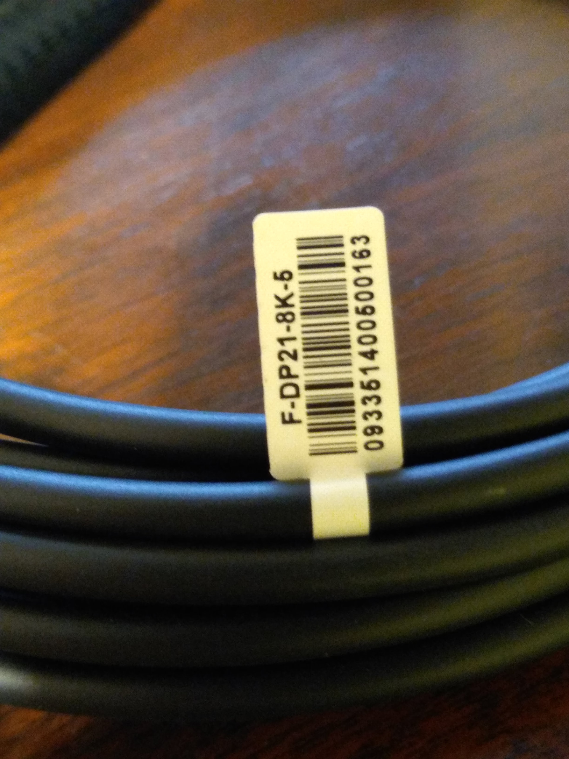

Cables are here. I won’t get to play until this weekend but these are them:
So far things appear to be "flicker-free”.
Going off @Level1_Amber ‘s suggestion I’ve been using copper cables - the ones I originally purchased with the kvm from L1 from the :robot: to the KVM, then fibbr to the monitors.
I’ve tested with both the 6ft and 4ft (copper) cables and all seems to be well.
