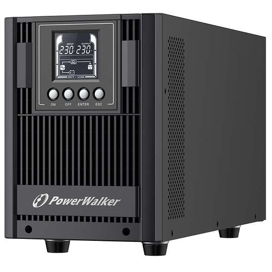

Anyway, this UPS costs roughly 300 bucks:
Is it any good or is something wrong with it?
