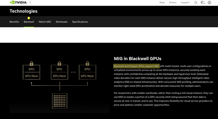

mmhmm and perhaps they could be so kind to remove this from their site :innocent: :
If eventually there is support, that would be lovely. A person i know pre-ordered two of the server editions and one of the workstation editions specifically because of the MIG feature, so if they end up only making that feature available for Hopper H100’s and stuff, that is very dishonest.
