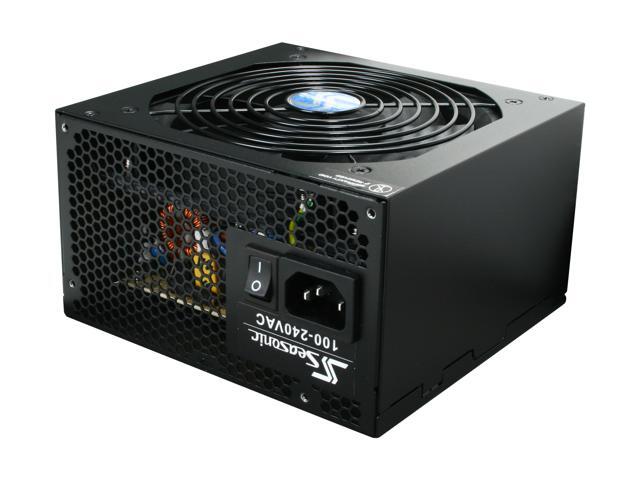

actually im trying to see if i can get a seasonic or superflow.....but need 350w minimum and would like to spend around $30
that's a tall order. best you're likely to do is a unit for 35-40:
@tkoham opinion? any seasonic ill be ok?
they both have good reviews for being budget PSUs, so yeah. when in doubt, check johnnyguru, or hardOCP
ok thanks for the info and help. Jonnyguru doesnt seem to review this one
Hardware secrets has a review on that:
I have the same one, had it for a few months now
I have the 520w version in service, and it runs clean as H*ck according to my scope
