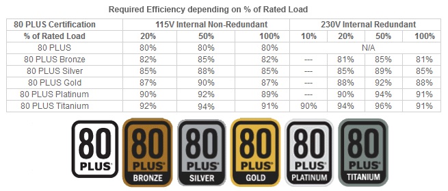

the difference will literally be just a handful of watts. The efficiency difference between 40% load and 80% load is only going to be a couple percent at most. I mean at a 400 watt draw we're talking at a difference of maybe 10 watts from the wall, assuming 90% efficiency at 80% load for the 500 watt unit and 92% efficiency at 50% load for the 1000 watt unit.
If both PSUs have the same efficiency at a given load (absolute power), then they will produce the same amount of heat. The more powerful PSU will just be better at dissipating it. So it might run cooler but the loss in energy through heat will be the same and in the end the environment will warm up the same amount.
But the better question is, what efficiency do both PSUs actually have under the same amount of load? Standard computer PSUs don't have the same efficiency across the whole range of possible loads, like @w.meri already pointed out.
So ideally you should pick a PSU that is first of all powerful enough for the maximum load that can be expected and second, it should be most efficient at the average load. So if your system usually runs around 150W for example and only sometimes peaks at 400W, then you should focus more on the 150W than the maximum load. And if the 500W PSU has a better efficiency at 150W than the 1000W PSU, you will save not just money on the purchase of the PSU but also the overall energy consumption of the system.

Efficiency curves etc.
